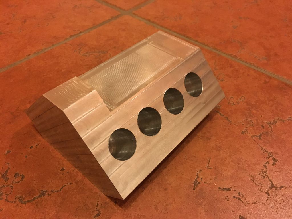

I bought alength of 7075-T6 bar a couple of months ago because it looked like it had the block for a V8 engine buried inside. After making a considerable amount of swarf, look what I found. I have roughed it out to allow any built-in stresses to relax before machining to final size.
Rough Block
There is a lot more swarf still to be removed, but it is at least starting to look the part.

I take it that is a 'small block' V8 wink

If I have done my maths right, it should come in at under 50cc. So yes, a very small block V8!
