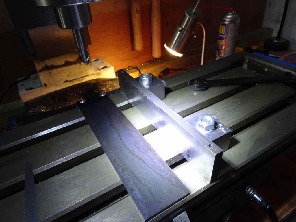

I've just finished what I'm calling a 'half vice' for my mill.
The immediate use is to square up a piece of 10 inch aluminium plate which will for the bases of a saw table for my femi band saw (slightly cheaper in parts than the real table and much much more expensive in labour!).
The Big square blocks sit in the t slots and are a rattle fit owning to the 3 slots all being different widths.The grey thing in front is an accurate T square made by milling across the bed with the backplate (hard to see in this photo) hard against the back of the table.

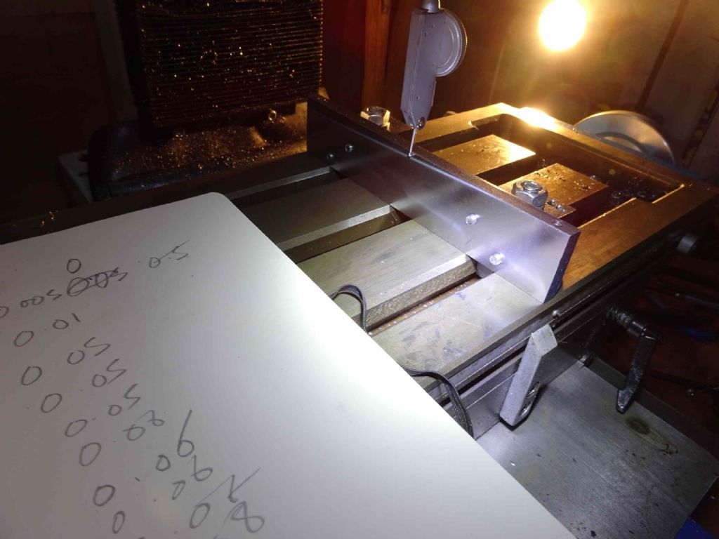

I wanted to see how accurate it was at an earlier stage of the build so squared it up with a big Angle and took seem readings with an indicator
On my second set of measures (after tapping it to properly square it), I found it to be within 0.05mm across the height and depth (which I was rather pleased with). Since then I've skimmed it (and got rid of the bolts sticking out), so I'm hoping it's even more accurate - especially with the new 'precision' T.
Tomorrow, I will measure it in the final version - I don't like to do so at the end of a job so I can retain my confidence in quality overnight!
