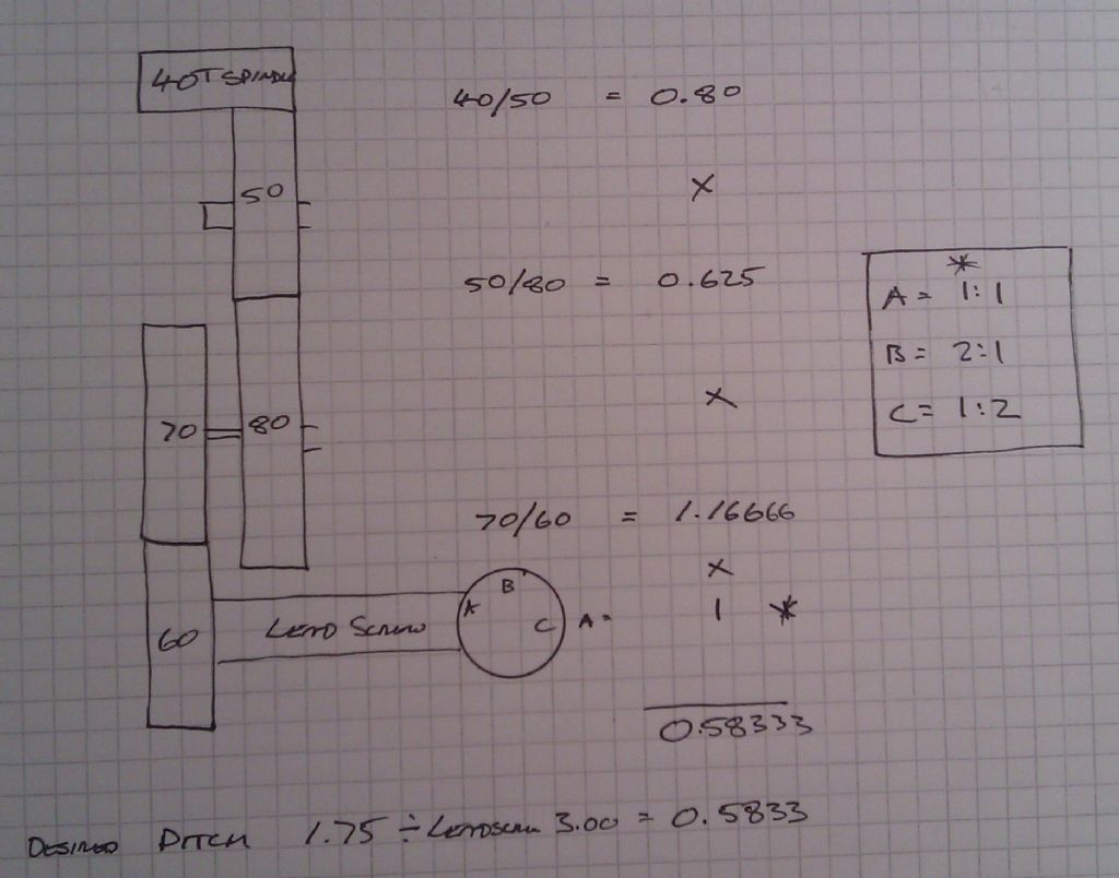

Hi everyone, I've had my WM250 lathe for about 3 1/2 years and up to now its served me well. I've come to stage where I need to cut a 12mm thread with a 1.75mm pitch. I've got to admit that I'm baffled by the thread table on the gear cover and also the manual. (which conflict on the gear sizes given) I can't work out what H & L mean (headstock & leadscrew perhaps?) Also it only shows 4 gears in the train, Z1 being represented by H, unlike 5 gears in the slow feed train. Also do the dotted lines in the manual or the small marks on the gear cover plate represent gears in mesh or gears on the same quadrant bolt??? Would someone please explain how I can arrive at the correct train. Thanks, John.

H means there is no gear, use a spacer either from when you remove the feed ratios or in the box with the change gears
L is the leadscrew gear
The vertical dash between mumbers show that the gear above meshes with the one below
Numbers side by side are on the same bolt eg Z1 & Z2 are on one stud, Z3 & Z4 on another

This may make it a bit clearer, gears based on the WM280 which may differ from the 250. to give 1.75mm pitch with metric leadscrew
Front selector in "A"
Click to make it bigger.
Do check it first as I have found errors in the 280 chart relating to which position the front dial should be in but have only corrected teh imperial threads as I have a 8tpi leadscrew

Thanks Jason for taking the trouble to do a diagram.I can get my head round it now and try the gears shown in both tables. I'll do a test piece first and check with a gauge. By the way mine is a metric lathe with a 3mm leadscrew.
Steve, is there a formula to check I'll eventually have the correct gears? ... John

John, this is the formula based on my Imperial 280 but assuming its got a metric leadscrew, the head and gearbox should be the same on both its just the leadscrew that would be different.
We know the leadscrew will move the carrage 3mm per revolution of the chuck but we want it to only move by 1.75mm per rev so 1.75/3.00 = 0.583333
Now to get the same number with the gears
Basically divide the driver by the driven so the 40T spindle drives the 50T, 50T drives the 80T, 70T drives the 60T, this gives us the fractions 40/50, 50/80 & 70/60 noe expressed as decimals 0.8, 0.625 & 1.16666.
The gearbox ratios are A=1:1, B=2:1 & C=1:2 which give the decimals 1, 2 & 0.5.
You now multipy these decimals so 0.8 x 0.625 x 1.16666 x 1 = 0.583333
If the two numbers are the same you have got it right. In our case they both come out at 0.583333

Thanks again Jason,you make it look so easy. I got it set up last night 30-80 70-60 but didn't have time to do the test piece. Will update. John

Just an update, due to your help I managed to cut the thread on my wm250. The nut fits very well with no shake. Set the topslide over to the 60 deg mark and fed that in 1.2mm. Its for the retaining nut on a new leadscrew I'm fitting to my Harrison milling machine. You'll notice I'm using a Diamond tool holder that comes with a jig to grind the tool to 6o deg. Thought it was a bit of a gimmick at first but if you set the jig screw at the correct angle (trial and error) it comes out great. Thanks again for your help. John

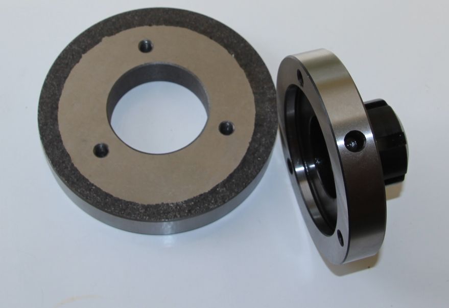

I ordered a new collet chuck with my lathe and would have used it this afternoon but discovered that the backplate that came with it needs to have a locating boss machined on it to take the chuck. Although the chuck has three tapped holes I was contemplating opening them up to clearance and drill and tap the backplate but then realised that the backplate has been hardened - so drilling is probably out.
Is it normal for WARCO to expect the customer to do the machining? Maybe the job is a better one done on the customers own machine - I don't know.
The backplate shown is "as delivered".

Backplates should always be turned in-situ to get them concentric to your spindle. Also make sure you put a mark on the backplate so it always goes back on the same way in much the same was as your 3-jaw is marked
The three tapped holes in the backplate are probably on the correct PCD for the studs that go through the mounting flange, you will need to drill for suitable fixings to attach the chuck to the backplate. Best to counter bore from the rear of the backplate and screw into the chuck, that way the front is nice and clear with nothing to catch your hand or tools on.
