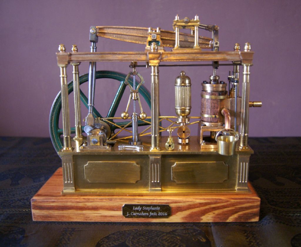

Here she is running, 95% completed, just the base to make and maybe engrave the side panels, we shall see.

Last one I promise.
Finally finished Lady Stephanie, (the spanner is engraved 'Snap-off Tools' ) laugh
What next? a simple clock? a miniature lathe?....
JasonB05/04/2016 16:47:10
avatar
25215 forum posts
3105 photos
1 articles
Very nice John, although the bare metal is not my thing you have done it well as its not overly polished - just right

the Lady Stephanie runs fine with just a link betwe
The Lady Stephanie engine runs fine with just a link between the beam and the piston rod , so why bother with a Watt parallel motion ? (which I trying to get right on my ST beam project ) !
regards PHIL
Because it's meant to represent a full-size one which would need parallel motion.

Yes, I've seen some with a simple link, I was just sticking to the drawing this being my first 'real' engine.
I went up to Kew to see the Dancers End engine it is loosely based on, excellent day out.
I know what you mean about the polish, I have a thing for brass and wood.
