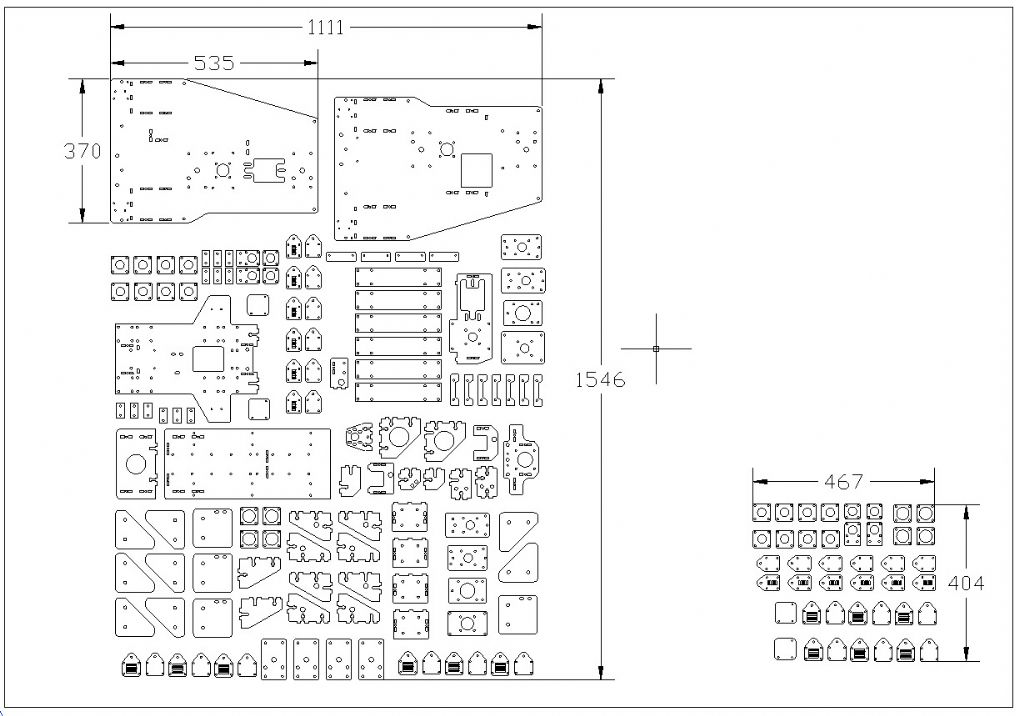

Material costs?
The machine is made from 5mm steel plate. Depending on the source that costs about $160 for a 2400x1200 sheet Plus Vat (GST in Australia). Plus minimum delivery charges.....horrendous for one sheet
I have attached an image of the cutline and a rough nesting as drawn the area is about 1.5 x 1.1metres. There is also a small number of 2.5mm steel sheet parts about a quarter of a square metre. The laser cutter may re-nest the parts for a better yield. and no we did not ask for the off cuts.
I avoid providing material to laser cutters unless it is special alloy, if there is any trouble with warping it is the laser cutters responsibility if they use their sheet. (Subject to their terms, conditions and tolerances sheet). Anyway it was an excellent job well within spec.
The actual price paid was $450 Australian dollars for materials and labour. Hence my rough stab at some sort of back of the envelope pricing model. Material Plus material x 2 = labour. For light steel.... Because this thread is read from many countries, I guess actual pricing comparison is rather error prone. Hence my avoidance of actual pricing in the first instance.
Laser cutters charge in several ways... a setup charge nominally around 50 dollars if you give them a perfect file that does not need reworking, (we did provide a good file). Otherwise there is a hefty hourly rate for redrawing. On top of this is the cutting length, and in particular the number of holes pierced; the machine has to run slower. (on this job rather a lot). Yes they make a profit on the materials, they need it to pay for large increases in power and gas expenses and machines that cost more than the median house.
For more specialised work there are different gases, at somewhat extra cost. Nitrogen for instance if you want a bright edge, without the fine blue scale left by oxygen, Different gasses also can improve the quality of the edge. Worth discussing if you have a critical application. We just asked for "run of the mill".
The connection.
Depending on the location you will find you need: bolt head sitting proud on top, countersunk below the surface bolt head on top, so you can place something flat over it. and sometimes nut on top. They all work fine. High tensile bolts and nuts are a must to lessen the creep you get from common no name hardware fastenings. Good quality shake proof washers are always a good Idea and have been used throughout this project. Nylock nuts are fine although not so the cheap import type, many appear to be rather soft poor quality steel. Maybe permanent Loctite is also a good idea.

A added a couple of rough photos, Better ones tomorrow.

Well done John, it looks good
[and, nice to see someone found a Beer]
You mention permanent Loctite; so let me offer one suggestion ... something we used very effectively on vibration test fixtures:
Use 638 or similar Loctite on the Mortice & Tenon joints, [don't waste it on the nuts & bolts] and you should achieve a "permanent" structure without needing to tighten the nuts & bolts too aggressively.
Although it's not stricly an adhesive; the joints you are using would respond very well, because the Loctite would be working in compression & shear ... which is, of course, exactly what it's designed for.
P.S.
Obviously you would only make some areas "permanent" ... but I'm sure I don't need to tell you that.
