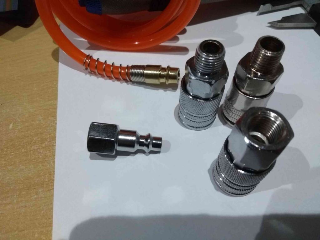

Iain Downs28/12/2020 19:15:54
976 forum posts
805 photos
This is not going well.
I ended up buying this. Mainly because I thought it was the right thing, but more that I could get it the next day (bless, Amazon, bless).
I have one bit of bad news and one bit of half bad news.
The bad news is that the connectors from the tool kit I got do not work with the allegedly Euro set purchased from Amazon.
The tool kit connectors are exemplified by the one on the tube. The kit connector is exemplified but the male connector at bottom left. They are quite different.
the picture below shows the innards of the Euro connector and the one on the compressor.
Quite different!
The half bad news is that the screw thread on euro connectors sort of matches the thread on the compressor. Sort of because it only screws in part way. Certainly less than the existing connectors. Which makes me think that the female thread is also tapered. And I'm not sure I can (Per a comment above) reliably use a non tapered male with a tapered female.
I'm stuck for what to do next. I don't know what the two mystery connectors are (the one on the tube and the one on the compressor connector). I've also struggled to find any male tapered connectors on Amazon (at least without paying a substantial price -and amazon includes BSP in searches for BSPT it would seem).
So. If anyone knows what the actual connector is on the compressor I can attempt to find a convertor. If anyone can recommend a supplier of BSPT connectors (at a reasonable price) I can replace the current connectors.
I'm still a bit stuck with what sort of tools to get. The ones I have already (as per the connector on the tube) or the Euro ones which Lidl/Aldi will provide cheap tooling for.
I really am stuck here, so any input would be appreciated.
Iain

There is some cross-over between the standards used by couplers. There are couplers made by PCL that will connect with Euro, ISO B12 and XF according to Air Technique Ltd. Have a look at https://www.air-compressorsdirect.co.uk/pcl-coupling/multi-fit-couplings

Your tube is likely a Chinese 'looks like a Euro connector' copy. If the connector does not freely swivel on the tube it will knacker anything you plug it into fairly quickly or the tube will twist up badly.
From the same seller alleged maker Dandlionsky you can have this Euro set, except the connectors look nothing like your Euro set by the same maker.
Be prepared to change the connectors on every air tool you buy, I do, but then I buy PCL and connectors bought in the last century still fit todays connectors.

Wait until tomorrow and go to a motor factors and buy proper PCL couplings. What you have, at that price will be nothing but trouble and leaks. They look like chromed mazak. Buy good quality hose that is a type of rubber, NOT pvc, in winter pvc and cheap hose will not bend. If you invest in good gear it will serve you well and last for years. I bought a CP 1/2" air impact wrench OVER 40 years ago,not cheap, it's never needed repairs. I was recently given a cheap copy, looks the same but has HALF the power - you get what you pay for ! Good luck. Noel

OK. A bit more Internet research and I think what I have are hiflow couplers. More specifically automatic hiflow couplers. Automatic means that you don't pull the sleeve back to insert the plug. Something I've been doing because, well, it seemed right.
It turns out that I can push both types of connector into my outlets, though I've not yet discovered if they actually seal and supply air - midnight is a tad late to pop out to the shed (especially in the current near-zero weather conditions!)
This has been the most useful site so far, but it's taken a lot of time to get this far! I will report on if the connectors actually work, tomorrow.

The connectors actually work!
I've plugged in the air gun to the coil and successfully blown air at things. The coiled hose is fairly useless at distributing air - despite it being 5 metres uncoiled, I feel it's not really meant to be stretched that much.
