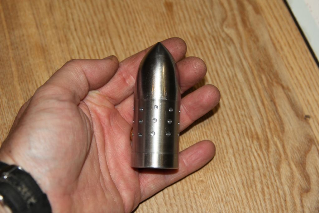

Hi all , give myself a break from the fabrication things and have some time out on the lathe to make myself a new paper weight, this is my attempt at making a Howitzer Bl 8 inch projectile in 2 inch scale , on the internet search they are 24" long without fuse and on the manual it states that the projectile is 28" long inc the fuse so this is made or as close as to the manual size , not a 100% happy at the shape but the more file work i did in the lathe the more i was making it to the shape i didn't like but i'll be making a bunch of these at the end of the build and will have them spot on by then.
Thanks for your interest Mal.img_20190221_225523.jpgimg_20190221_225404.jpgimg_20190221_225426.jpgimg_20190221_230036.jpg

Nice shell - how did you fit the driving band?

Mal, the shape of the nose of the shells is either 1 x diameter or 2cr . sometimes referred to as Krups no 1 or Krups no 2. Now of course we use bottle nose shells with thinner walls.

Posted by Clive Hartland on 25/02/2019 11:12:27:
Mal, the shape of the nose of the shells is either 1 x diameter or 2cr ...
Have to get up early to catch Mal, I reckon his shell is exactly 2CRH (calibre/radius/head)
While I'm in rivet counting mode, I think a simple 2CRH shell may be historically unlikely for a 1917 gun. Under pressure of war to improve range and accuracy, shell designers made rapid progress with streamlining after 1914. A 2CRH shell is right for earlier marks of the gun, but suspect ammunition fired in 1917 would be been made with a sharper Compound CRH.
Does anyone know?

Thanks for the interest and comments guy's. just had a quick read up on the shell and in 1917 or around that time it reads in the manual. The common steel shell had an ogival head struck with a radius of four calibres , so will have another go at getting it wright.

Posted by Mick B1 on 24/02/2019 19:13:29:
Hi Mick ,the bottom of the shell is all brass with a steel collar press on to give the impression of a brass band.

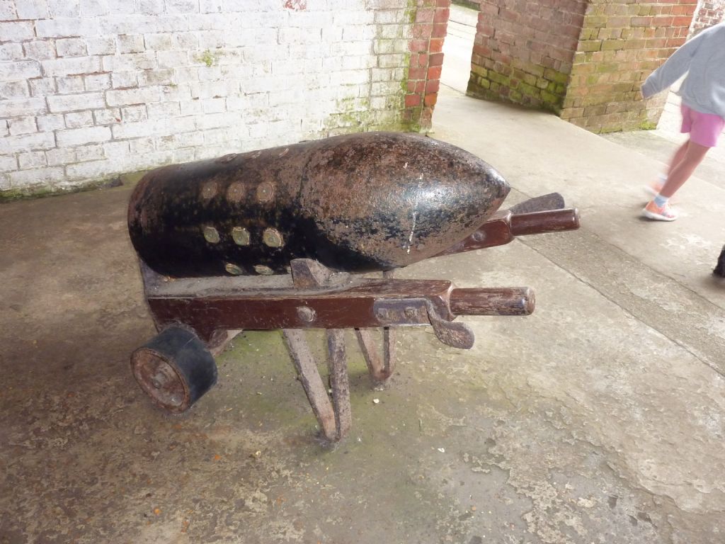

Mal
Nice shell. Here's a 12.5 inch RML paperweight I have been making.
Regards Rich

Posted by Richard brown 1 on 25/02/2019 15:33:27:
Mal
Regards Rich
Hi Rich, looks like you got the shape to that bang on nice work , just had a little read up on this and as you know and i think it is a 800 pound shrapnel shell fired from a 38t gun the howitzer was a 200 pound shell obviously a hole lot smaller,are you going to but the brass coloured plugs in it that pick up the rifling.
Thanks for the interest Mal.
Buffer26/02/2019 12:27:21
430 forum posts
171 photos
Mal
Its an 800lb palliser shot copied from the dimensions in the handbook. Yes i will black it put in the brass studs and then make a little shell barrow. Just for a bit of fun.
