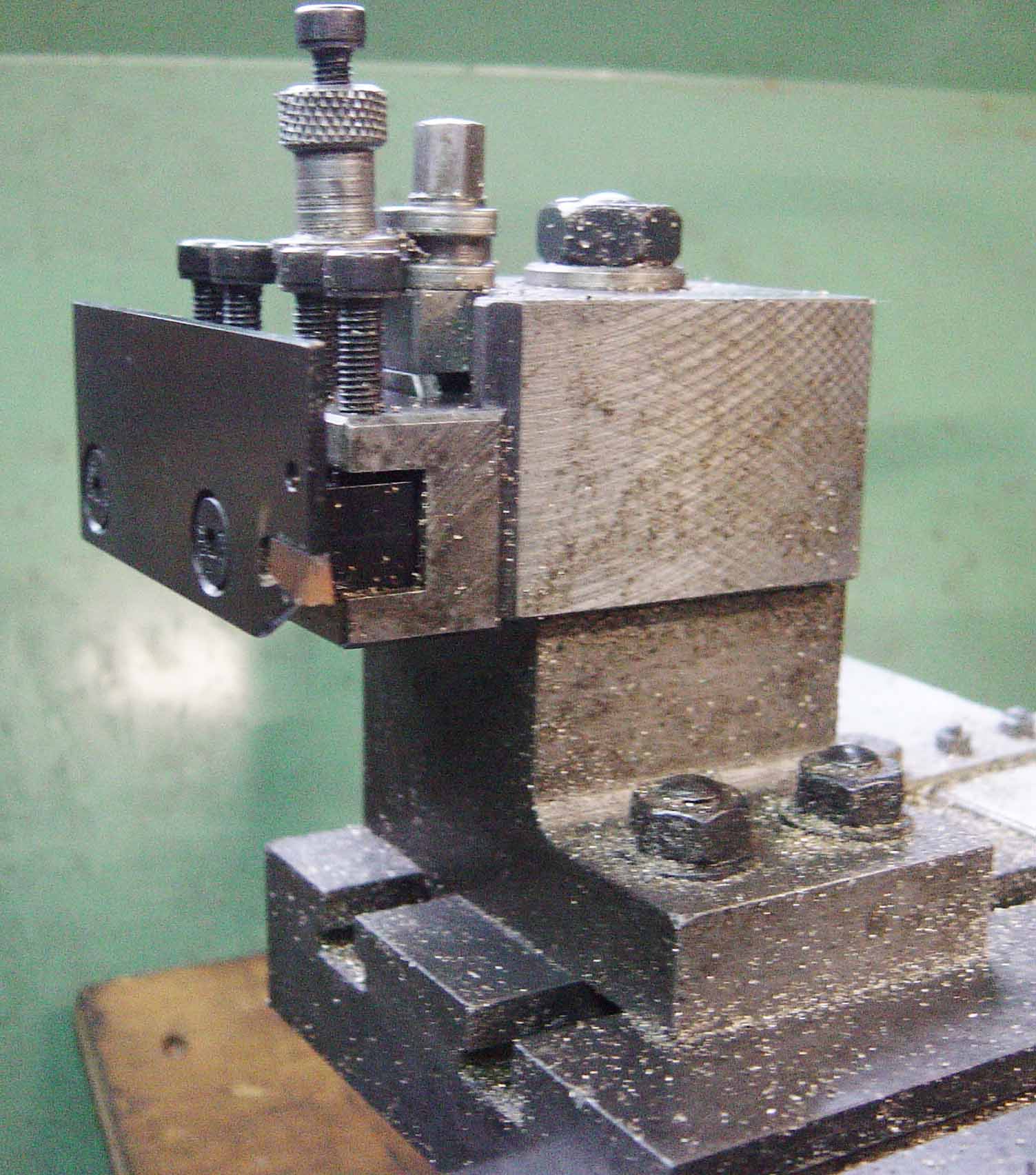

Martin Kyte15/12/2015 11:04:21
avatar
3445 forum posts
62 photos
That's not a Myford rear tool post that's a rear toolpost mounted on a Myford and as built it's clearly not adjustable for centre hight.

Michael Gilligan15/12/2015 15:44:08
avatar
23121 forum posts
1360 photos
Posted by Alan Jackson on 15/12/2015 10:23:24:
I made a base with a slope so that the upper part can slide to the right height.
That's very neat, Alan

Emgee15/12/2015 17:44:09
2610 forum posts
312 photos
rtp adjuster.jpgThis RTP may be like Alans, made by a toolmaker many years ago, could have been from plans I'm not sure. I find it very useful for grooving and parting without problems.

Howard Lewis15/12/2015 21:46:46
7227 forum posts
21 photos
Sorry to take issue with Mark P, but a rear toolpost is a boon. It seems to solve parting off problems for many people. This will probabl;y reignite all the theories as to why/how!
I was sufficiently impressed with the results from the one that I made for my ML7, that I made a four way one for its larger oriental successor, to carry a front chamfer and back chamfer tool, as well as the parting tool. It VERY rarely leaves the Cross Slide, maybe because of the chamfering tools, but wouldn't be without it.
Again, my advice is to mod the post, as a "once and for all time" job, in case you ever find the need to mount any other tool on it.

Michael Gilligan15/12/2015 22:27:43
avatar
23121 forum posts
1360 photos
Grotto,
My summary:
  • The toolpost is about 2mm too high
  • The base has a tongue, which you would prefer to keep
  • You don't have either a milling machine or a shaper
My suggestion:
  • Saw the post into two, at some convenient horizontal.
  • Face each part in the lathe [having first checked that the lathe faces 'flat' or 'very slightly concave' as per Dr Schlesinger's recommendation]
  • Re-assemble, and check the new height [repeat, or add shim, as required]
  • When it's "just right" you can [optionally] add dowels, adhesive, or whatever, to keep the two parts in register.
  • Live happily ever-after smiley
