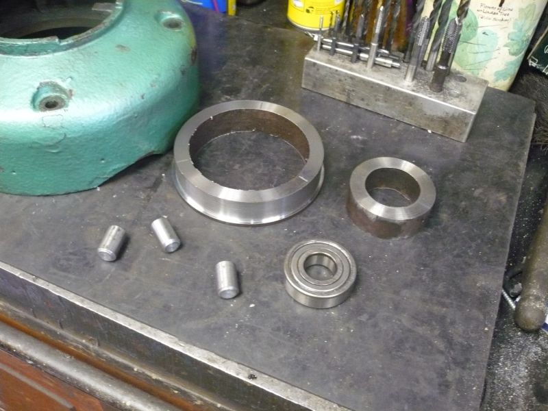

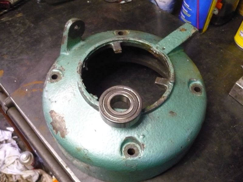

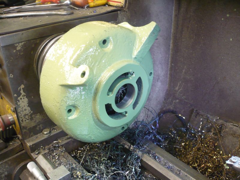

Judging by the build up inside on various diameters it's off some sort of pump. Should be a boos in the middle to take the bearing but it's gone walkabout somewhere.
Told can't use a solid plate as it needs vent slots in it.
So raid the scrapbinium rack and get this lot.
Followed by a bit of judicial hammering, banging, crashing and weld it where it touches and we get.
Just so not to upset the flat earth society it got wafted with one of Mr Warco's finest rattle cans which should also add threepence to the bill, scrub that it's Friday so we'll call it sixpence.
First pic timed at 12:13, last pic timed at 1:13.
Can I get me diner now ?
