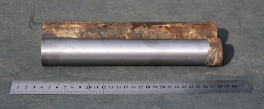

Roy - sounds like the dull ones are probably very slaggy and as such might as well be discarded.
I have 20 of these weights of which just 3 are soft enough to saw yet they ring like a bell. The other 17 have hard skins. Last week I set to on one of these hard ones with an angle grinder as Jon Bogs on here recommended. Went in about 6mm deep all round, held it up by the other end and whacked it with a big hammer. The end broke of easily.
Gripped the other end in the chuck and tapped true and centre drilled the snapped of end. Running centre supported I attempted to get under the skin with one of those cheap brazed carbide tipped tools but my poor little lathe (WARCO 250) really objected with both saddle and tailstock visibly doing the jelly wobble.
I finally managed to get down to the nice stuff but only for a 6mm length before the tool tip blunted big time. The length sticking out of the chuck is approx. 250mm so if I am going to tame this thing and skin the full length I will have to attack it with another type of tool.
This is not being made any easier because the weight has been cast more with an elliptical cross section than circular.
Jon swears by this method but I suspect he is using a lathe somewhat heftier than mine.
Don’t know whether you have machined cast iron before but a face mask comes in handy (unless you have black pillow cases).
Rik

Rik, after you whack the end off with the hammer, it pays to look at the break, if its grey OK, but if it's bright and crystalline forget it, although there is half a chance that the other end is OK. Get the fattest weights you can, there are some about 2" diameter, mine have 18 cast on them, I did not check, but that might be the weight in pounds.

Rik Shaw22/05/2014 10:02:48
avatar
1494 forum posts
403 photos
Two halves of a single sash weight, one still in the "raw" and one cleaned up and ready for use. Each one yielding a 10" long by 1.5" diameter length of silky smooth seasoned CI...........
............and another small selection of brass and CI ready for re-cycling.
Acquiring materials like these for next to nothing puts a big smile on my face. laugh
Rik (somewhat filthy after turning that bit down)

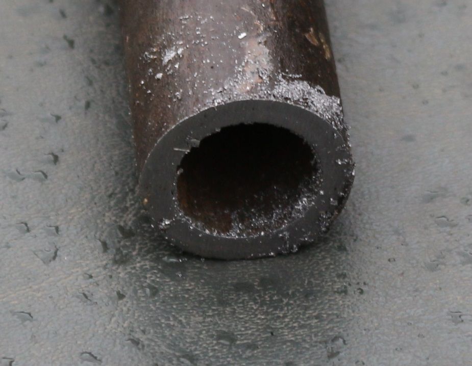

Rik Shaw26/05/2014 18:48:52
avatar
1494 forum posts
403 photos
Thanks for the enlightenment John. Whilst on the subject, I dug up (literally) a bit of ancient old gas pipe which I turned a bush from some days ago. I used my best sharp knife tool and the stuff came of as ragged as a witch's knickers. I fully expected such old stuff to turn quite nicely so was surprised. Never can tell can you?

Ian S C27/05/2014 11:08:30
avatar
7468 forum posts
230 photos
The old gas pipe will be like water pipe, quite soft to allow the pipe to be bent easily, it will cut not too bad with sharp tools. Sometimes if you'r unlucky the weld will pop, I'v had that happen when I bored the inside, I rewelded it from the outside, and it's still in use as the power cylinder of a hot air engine built in 1992. Ian S C
Rik Shaw27/05/2014 17:54:33
avatar
1494 forum posts
403 photos
Ian - I think we might be talking about two different things. You'd never bend this stuff as the walls are to thick and its seamless as well. My best knife tool will slice through tool steel a treat but not this stuff.
As far as I know, gas pipe over here does not get bent - it is threaded and then fitted with a cast iron bend. If I'm wrong I'm sure someone will take me to task. (Thinking about it, this might not be gas pipe at all - but it's still c**p stuff to machine.)
