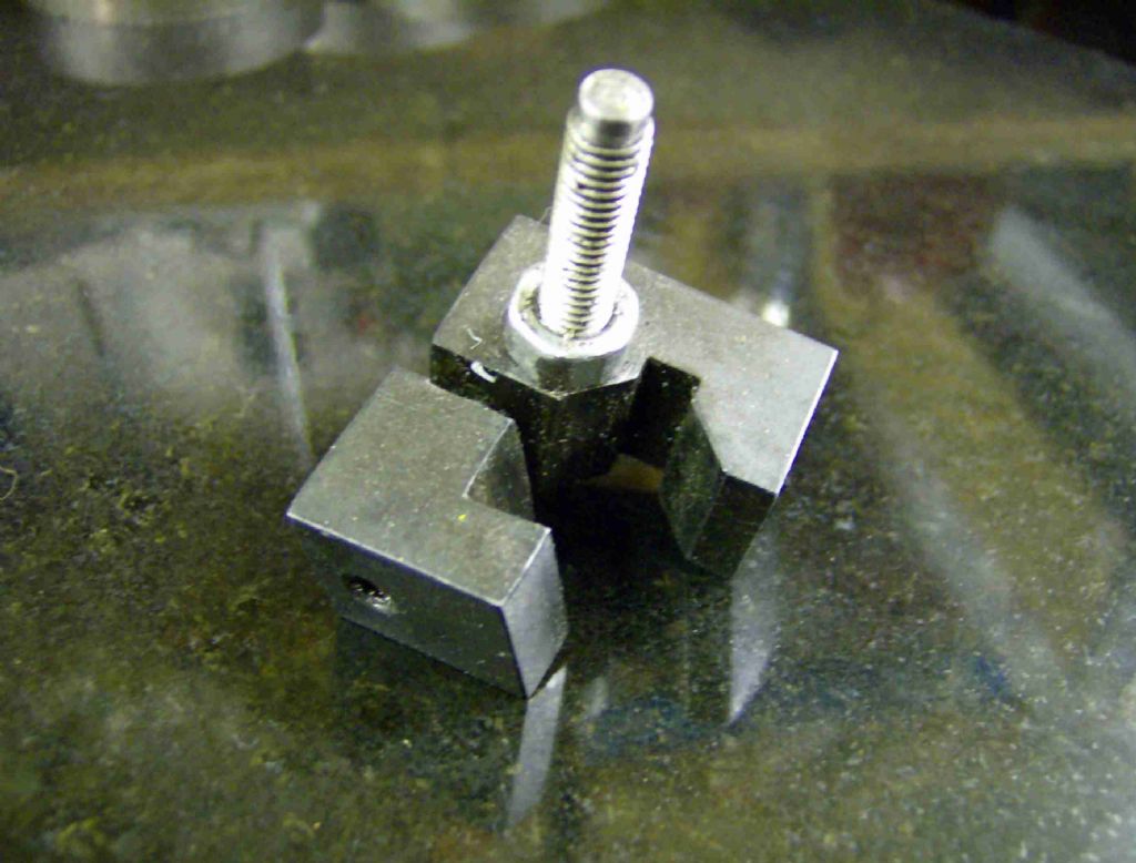

I have used jenolite koldblack for small components, it even blacks brass-just. I used it to disguise the brass chain on my crane.
You get a more even result by quenching in oil, and you don't even need to use motor oil - I use a golden syrup tin half full of rapeseed oil for medium sized components and it gives a good, durable finish.
The clamp in this picture (taken yesterday) was blacked in rapeseed oil years ago.
The pale colour is an artefact caused by me photographing a black object on a black granite block.
