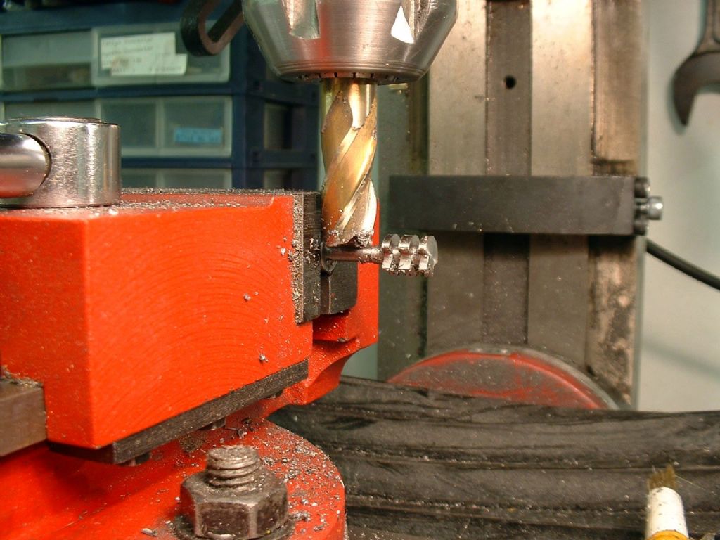

Stub Mandrel25/10/2011 21:05:54
avatar
4318 forum posts
291 photos
1 articles
Ramon,
Your cutters are things of delicate beauty, so I hate to criticise, but for similar tools I don't bother with side clearance, or if I do just machine the disc from which the cutter is made slightly concave. Instead of your elegant curved backs, i just mill across at an angle to leave the slightest witness behind the cutting edge.
'Works for me'
Here's a nice big endmill making a little three-gang cutter (to an ETW design).
And proof it works:
Edited By Stub Mandrel on 25/10/2011 21:07:39
Ramon Wilson25/10/2011 22:55:30
avatar
1655 forum posts
617 photos
Hi Neil,
Yes I know where you're coming from and indeed thats how I set out on these cutters originally. I dished them both sides thinking that that would be sufficient clearance after all it's only the very tips that are doing the cutting. I think the problem here was mainly due to the thin nature of the cutter and not enough meat to allow a sufficient clearance angle.
However those first two just rubbed and wore so quickly and did in fact spoil the first (steel) cylinder (not referred to in the text!). The last, as said sailed through with ease however the fact that it was left hard - ie not tempered - as well as backed off probably improved matters as well.
As drawn it is, I confess, a bit of artistic licence without realising the implications. This is how they were actually made the bottom right hand one being the one that worked very well - still usable infact
Hmmm, I've only just realised that I drew them with three teeth and made them with five
Thanks for your input though - all noted for any future drawings
