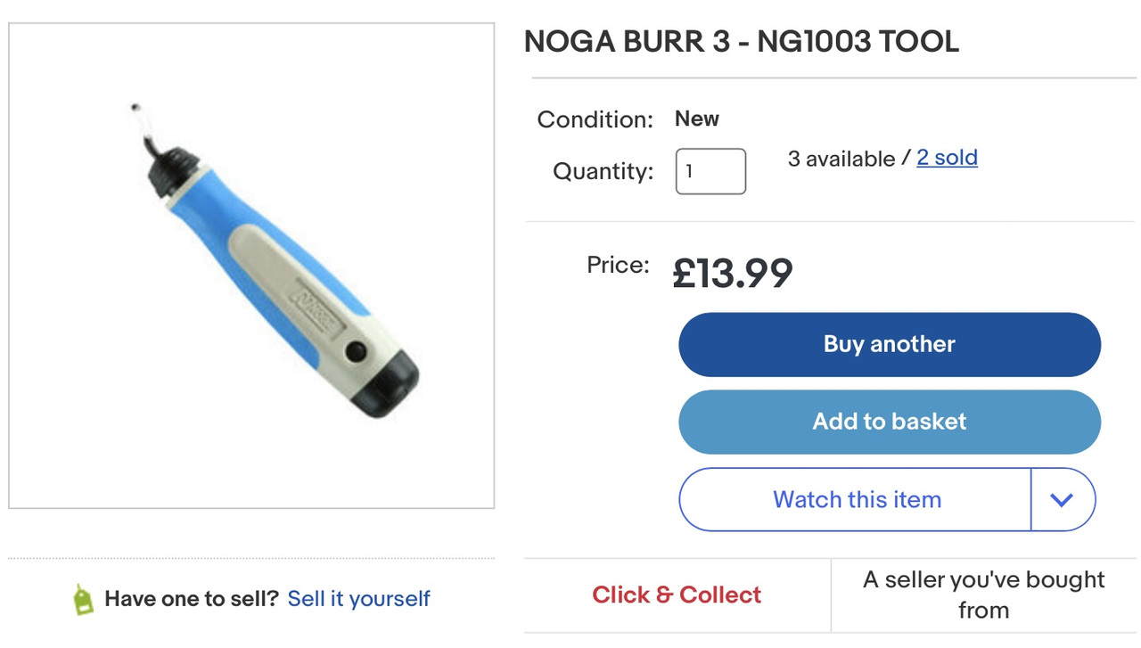

Bill Phinn24/08/2022 14:42:40
1076 forum posts
129 photos
Posted by Vic on 21/08/2022 10:15:03:
This looks to be such an exact copy of the Noga, how do they get away with it?
It could well be made by Noga, but sold unbadged through a reseller.
At £13.99 it doesn't look particularly cheap to be a low quality impostor.
If you wanted an alternative, guaranteed genuine-brand made-in-Israel deburring set, why not get the Shaviv 29249 Bonus Pack for Extra Close Work Mango IIB with 10 x B10 Blades, currently £2.50 less (on Amazon) than the offering Vic has reservations about.
As for SwissBurr deburring tools, I believe these are one of Grainger/Zoro's own brands. Who makes them for them? I'd put my money on it being Shaviv.
I can't detect any difference in quality between the Shaviv, SwissBurr and Noga blades or the Shaviv and SwissBurr handles I have.
