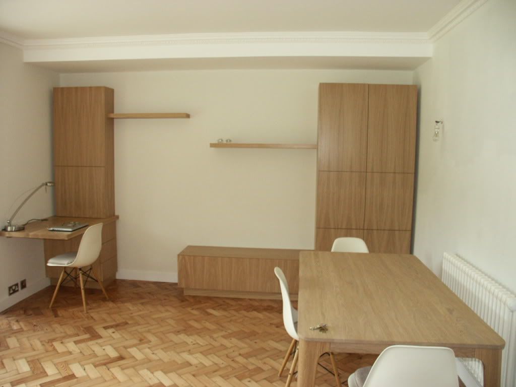

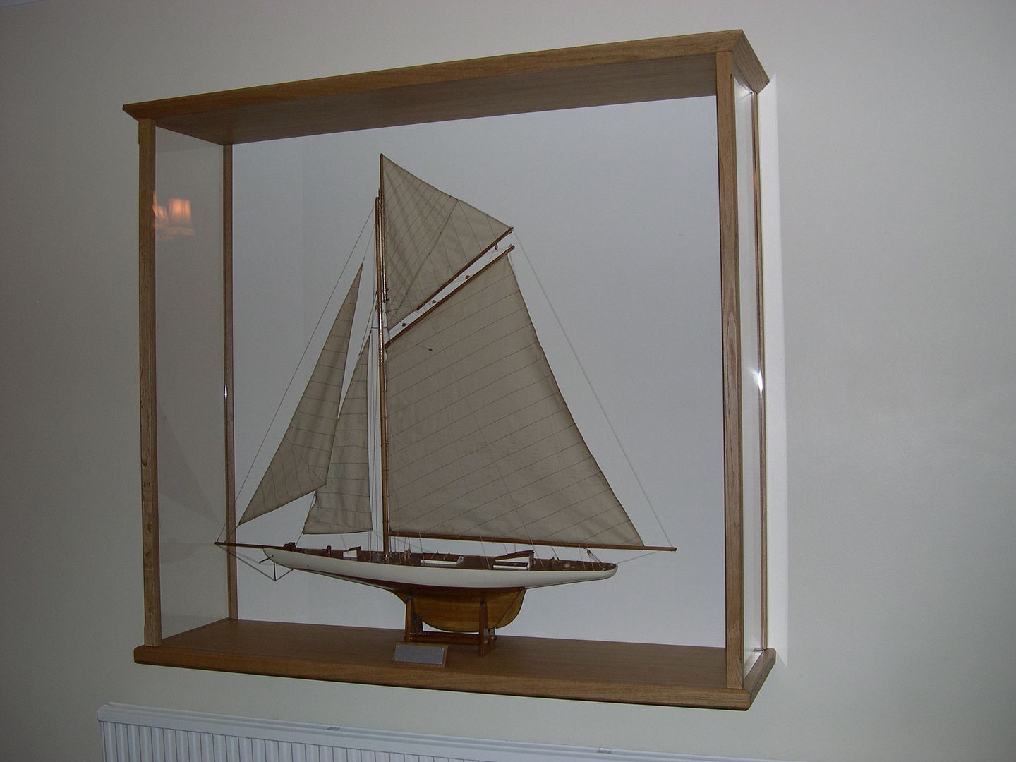

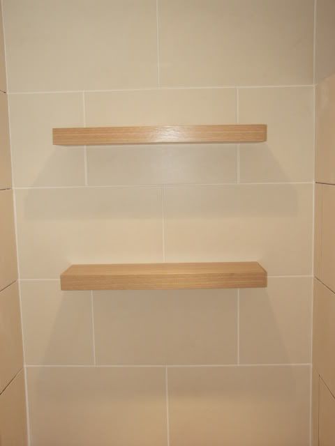

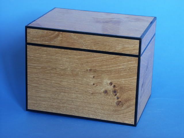

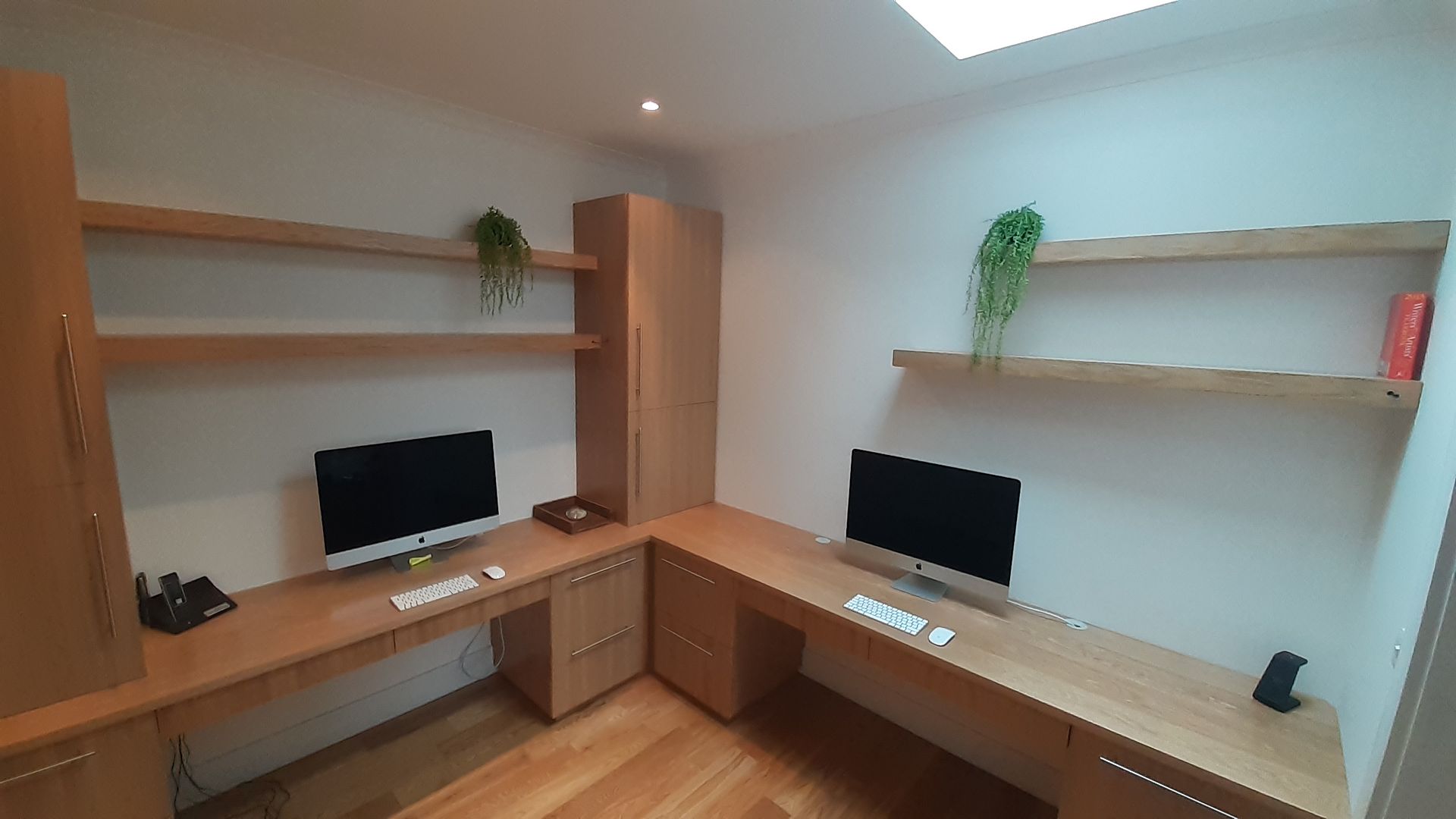

A few such constructions
And a couple of cabinets for boats

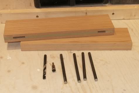

The first option described is like this
Some strips of 18mm MDF say 35mm wide glued onto a piece of 6mm oak veneered MDF with a second piece on top. If you make that structure 1020 x 220 once dried it can be cut down to 1000x200. Then glue some strips of 6mm x 30+ oak around the sides. once set plane/sand flush and then cut your chamfer.
Second option is to just glue up solid or with the strips again but just use unfaced MDF.
Once that has been cut to 1000x200 cut a 6mm x 6mm rebate along the edges you want chamfered and glue in some strips of 6x6 oak or a littkle larger and plane flush so you end up with a core that looks a bit like this box where the oak would be your MDF and the ebony your 6x6 oak strips
You can then veneer the ends & trim flush. Veneer the front & back and trim flush. Veneer the top and bottom and trim flush. Finally cut the chamfers which won't expose any MDF as it will just be the soak stringing that shows through
