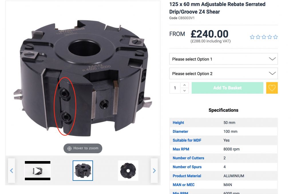

Thread: Differential Screws
30/10/2022 00:08:50
29/10/2022 23:46:52
I don't know about their use in engineering tooling, but, the ones in your first picture are used in spindle moulder tooling, (wood machining), along with an olive, (cone shaped nut), to hold the wedge, which locks the knives into the block.
It is not very obvious how they are used from the links below, I can takeyou a picture on Monday if you want.
Screw
Olive
Mark.

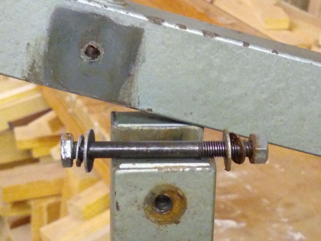

Thread: Diamond Fret Saw
03/06/2022 22:54:02
Hi again,

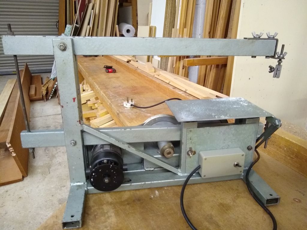

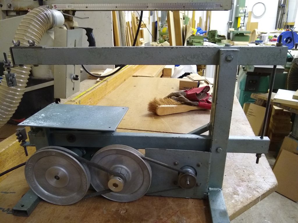

here are pictures of mine, including with pivot bolt removed. It is a plain shank bolt, running in round steel tube bushes within the box section arms, so nothing special.
My saw may not be the same as yours, I think they were improved over time, mine has no guarding to the pulleys etc, although they are well covered by the 18 inch table, when fitted.
Regards,
Mark.

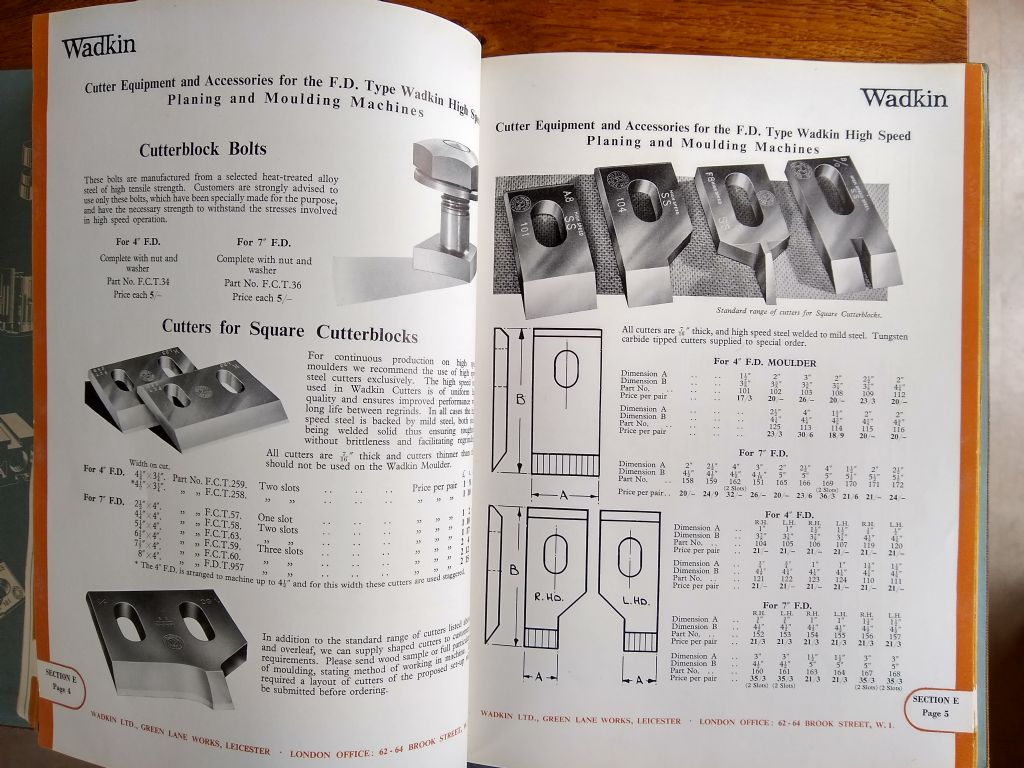

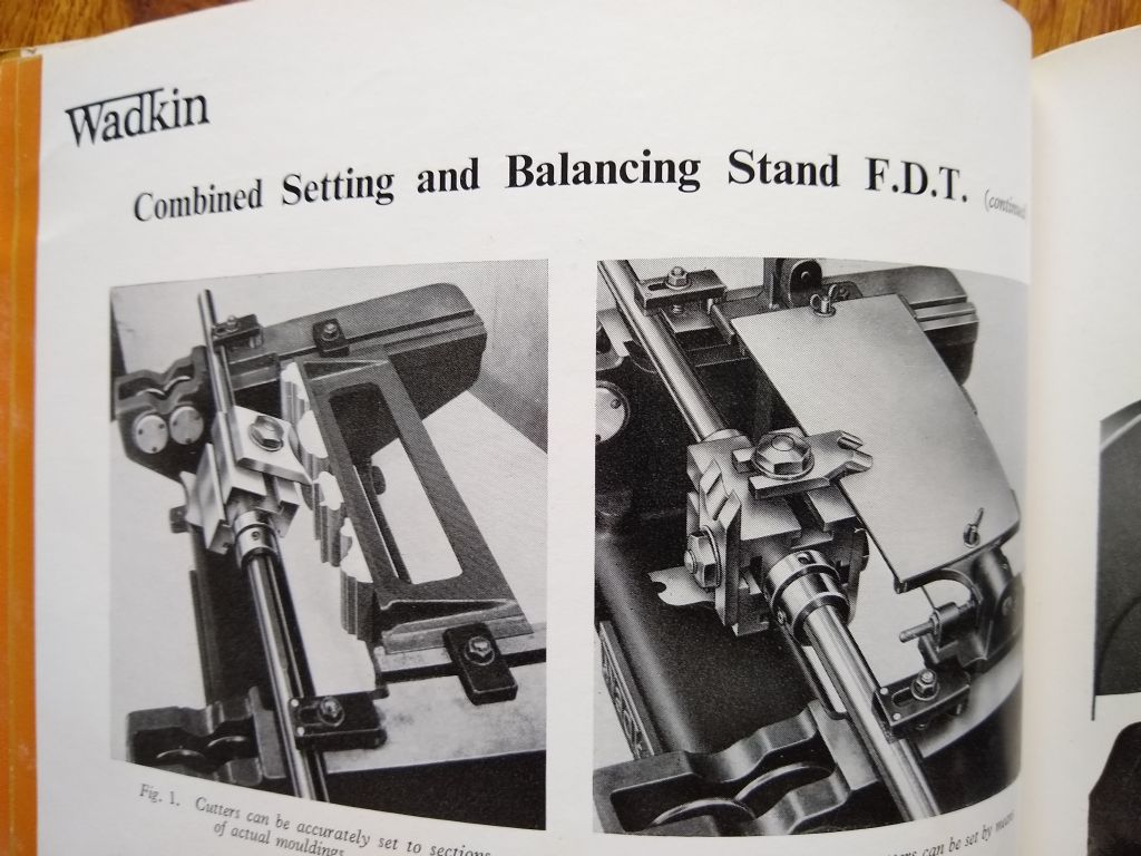

They look like "cutters", "Irons", or "knives", as used in woodworking machinery such as multi head moulders, spindle moulders and tenoning machines. The HSS is usually just a thin piece laminated to mild steel or similar, as seen in your picture of the edge of the cutter.
The cutters are held on a Tee slotted Square Block by a single bolt. The "open slot" type were frowned upon or possibly banned before the "closed slot "type, as they could more easily fly out of the machine!!! All this type were banned around 1998 if memory serves.
Think of a couple of axe heads spinning at 6000 RPM!!!
Couple of pictures from a Wadkin catalogue circa 1954.

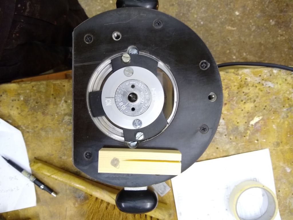

Trend Router Bases are tapped M6, so you only need a clearance hole and counterbore.
Plastic/Nylon/Wood would also be ok to use. The Trend one is probably plastic, so it won't mark the job.
For Reference the piece in this picture is 70mm long x 20mm wide.
The Guide Bushes are flush with the router base, so don't add anything to the thickness of the jig.

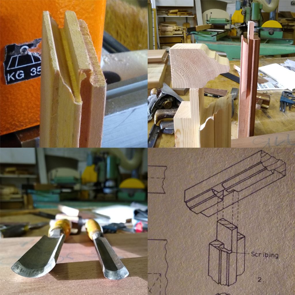

Basically, scribe the tenon shoulder over the moulding, as others have said.
Top Left shows the kind of joint produced with the scribe and mould cutters, as Jason linked to, which creates a stub tenon which fits into the panel groove. This relies on the glue holding the joint together, great for cupboard doors, no use for house doors. (This was done using Spindle Moulder Cutter Blocks).
Top Right shows through scribed joints, the Sapele one was done on the Tenoning Machine in the background, the Softwood one by Bandsaw/Hand Tools.
Bottom Left, the kind of gouges required to create scribes by hand, are the in-cannel type, i.e. inside bevel.
Bottom Right, when scribing wide rails on Doors etc, if doing it by hand you only need to scribe ½ inch to 1 inch say, the remaining shoulder can be left square, and a section of moulding chiseled away on the stile, similar to the drawing, which is of a frame.
