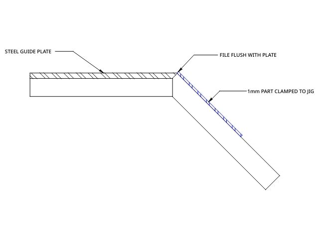

1 mm is very thin. Even if your 45 degree angle is absolutely perfect, you're going to have problems ensuring that the parts remain flat enough to obtain a <0.1mm gap all the way along the edge.
Given lack of space, equipment, etc., I'd make a simple jig out of MDF, flat-topped, with a piece of steel plate screwed to it, and an angled support at 315 degrees to it to clamp the part to. Use appropriate fences and dowels (through previously drilled holes in the part, as per your drawing) to register the part so that the edge to be chamfered is just above the steel plate.
Then file the chamfer level with the plate. You can let the file contact the plate to guide it. It will last long enough for the purpose.
Add fences, stiffening webs, etc. Draw filing is probably the way to go.

Considering that it's just sheetmetal, and the number of parts required, I'd be more tempted to file a clamp-on jig and buzz the whole lot across a cheap belt sander.
45 degrees on a 1mm part is more like sharpening a blade than chamfering.
