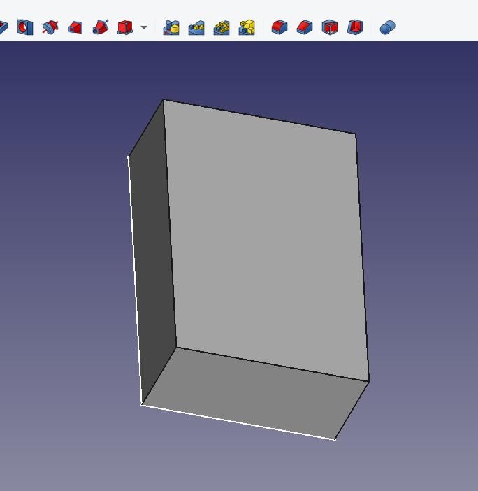

Tony asked about software for printing and I pointed to FreeCAD and a tutorial showing how objects are developed from sketches into 3D. Various alternatives have been mentioned, and plenty of nice photos of what can be done but no-one has explained the actual workflow. I'll use FreeCAD to make a box and Cura to print it.
First sketch a rectangle and pad it to make a 3D block
I won't describe the detail, but the block's corner are filleted, 4 screw-holes pocketed, and then the block hollowed out by pocketing a third sketch. The result:
So far the object is just a FreeCAD model. The next step is to export the model from the File menu, top left. FreeCAD Export supports many options, but most 3D Slicers (which instruct the physical printer), work from STL. Select STL Mesh and save the file.  We're done with FreeCAD.
Start Cura, or other slicer and open the STL file exported from FreeCAD.
Next step is to use the STL file to print the model. It's not done by FreeCAD. Instead a slicer is needed, this demo is done with Cura, which is free. The slicer translates STL into a series of layers 'slices' that are extruded one at a time by the printer to build up whatever walls and holes are needed to create the wanted shape. The slicer is told which printer is connected and controls type of plastic, nozzle diameter, percentage infill and other manufacturing parameters.
As a sanity check slicers usually display what they think the object looks like (the shape and size should be identical to the FreeCAD model, but things go wrong), estimate print time, and how much plastic will be consumed.
FreeCAD and Cura cope well with simple engineering objects like boxes and parts. FreeCAD's not so suitable for making curvy artistic objects. The type of model wanted may influence product choice.
