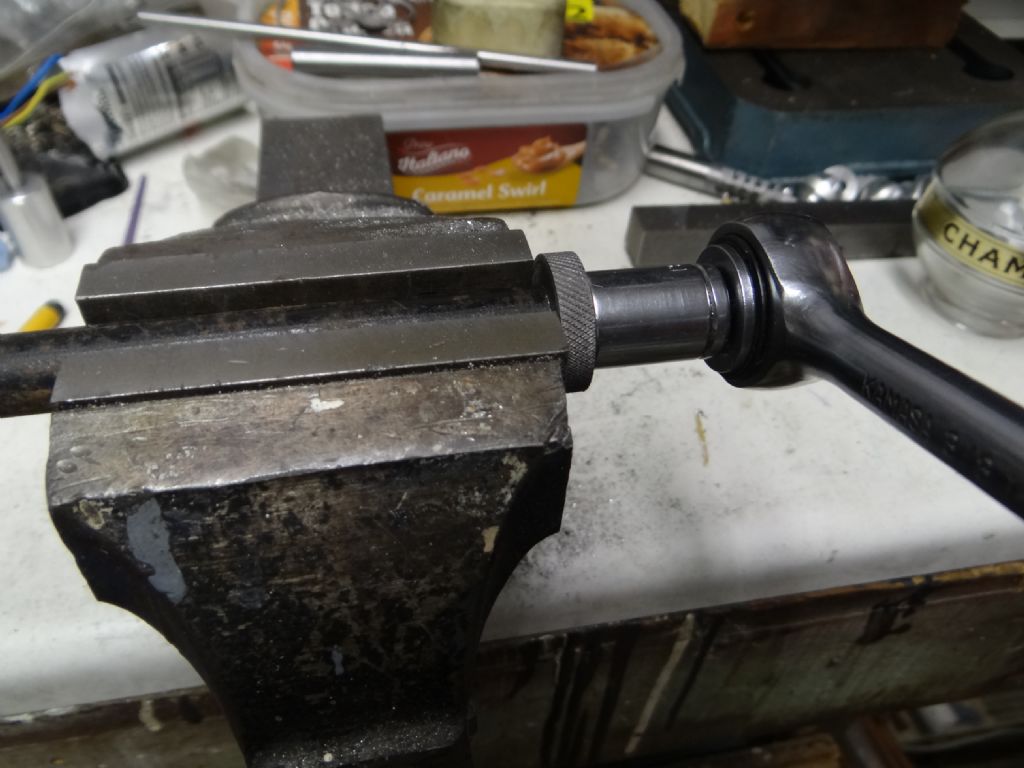

SillyOldDuffer15/08/2017 17:28:46
10668 forum posts
2415 photos
The experiment and results you've all been waiting for! I hope it's worth it because I broke a NCIH parting blade making a thick washer.
I took a 750mm length of 1/2" O/D thick walled steel gas pipe and passed a metre of M8 DIY store studding through it. Each end was terminated with a 6mm thick steel washer and an M8 nut.
One end was held in a vice and about a kilogram of scrap was loaded on the other.
A bamboo pointer was stuck on the far end of the pipe.
The picture above is of the pointer position with the nuts cranked tight, ie with the pipe compressed. A pencilled mark records the position.
Tightening the nut caused the end of my pipe to move downwards. That's not what's expected if the pipe becomes more rigid when compressed due to tightening the studding nuts. Loosening the nuts causes the pipe to rise back to the start position. Again this isn't what I expected if pipe rigidity was being improved by compression.
I think the pointer falling as the pipe is compressed is due to the pipe bending. It follows the line of least resistance, and reinforces the pre-existing bend due to gravity. The pipe behaves like a spring, not a stiffened rod.
I put enough force on the nut to damage the thread on the studding.
Twanging the pipe to make it vibrate wasn't any more encouraging. The amount of tension on the studding doesn't seem to effect the amplitude and duration of the pipe's vibration one way or the other.
Unless there are experimental flaws (feel free to point them out), it looks very much as if compressing the pipe has no useful effect. In other words my experiment suggests 'bunkum' is more likely than 'rigidity improved'.
I can't claim the experiment is conclusive because the M8 studding I used isn't a tight fit inside the gas pipe. I suppose it's just possible that a much tighter fit would stop the pipe bending.
Roderick Jenkins15/08/2017 17:56:11
avatar
2376 forum posts
800 photos
Nice experiment. I think the studding needs to be truly axial. By shifting the studding in the tube you can probably get it bend the other way - similar to a truss rod in a steel strung guitar, which is purposly non-axial to counteract the pull of the strings and bring the fingerboard back to only a slight concavity.
cheers,
Rod

Clive Brown 115/08/2017 18:24:51
1050 forum posts
56 photos
The tube might not have been quite straight and / or the end faces not truly square.
JasonB15/08/2017 18:29:04
avatar
25215 forum posts
3105 photos
1 articles
The weld down the length of the pipe will more than likely have an effect on which way it bends too.
As Rod says a top hat washer to keep the studing central in the bore would also reduce the tendency to compress one side more than the other.
Michael Gilligan15/08/2017 18:37:22
avatar
23121 forum posts
1360 photos
Well done, Dave yes
Just one [maybe significant ?] point from me ... You are stressing the tube in the opposite sense to that boring bar.
i.e. you are tensioning the studding; which compresses the tube,
but they put pressure on the rod; which stretches the tube.
SillyOldDuffer15/08/2017 20:18:24
10668 forum posts
2415 photos
Posted by Michael Gilligan on 15/08/2017 18:37:22:
Well done, Dave yes
Not so well done I fear - you're right , I need to push, not pull. Now we know why peer review is so important. Ah well, back to the drawing board.
Well spotted Michael.

Sam Longley 115/08/2017 20:22:57
965 forum posts
34 photos
You are compressing. the tube but due to missalignment of the studding within the tube you are applying the force asymetricaly.
I would suggest that you turn some nuts round to make a sliding fit within the tube. These should be placed at close evenly spaced intervals along the studding which can then be inserted inside the tube. Hopefully this woul keep the studding central whilst pre stressing takes place.
In theory under normal load the tube will want to resist deflection if placed as a cantilever. As load is increased it will react wiithin itself to resist this deflection.tension will immediately occur in the top sector
If one prestresses it the initial stages of tension are counteracted by compression & until the 2 forces balance bending will be significantly reduced( subject to what happens in the bottom sector) if the stud had been placed in the top sector the tube would have bent upwards but we want a demonstration of an axially placed rod so compression applies on upper & lower sectors equally. This should not affect the increased performance of the prestressed unit.
However, one has to consider how much compression can be applied by a single set screw & if that is adequate to make a difference
It is 50 years since i did theory of structures so cannot prove mathematically anymore----apologies

duncan webster15/08/2017 21:52:50
5307 forum posts
83 photos
Dave, what you have is akin to a bow (as in Robin Hood). The tube is bent because of the side load, you are then applying a pull along a straight line between the two ends, not co-axially down the bar, so it bends more as it would if you tightened a bow string. As well as being in the wrong direction, it is not the same as a close fitting rod down the centre which would be forced to bend with the tube, and so would apply any force co-axially. If the push rod in the Dore bars is not a close fit all the way down, I might be prepard to amend my previous opinion!
