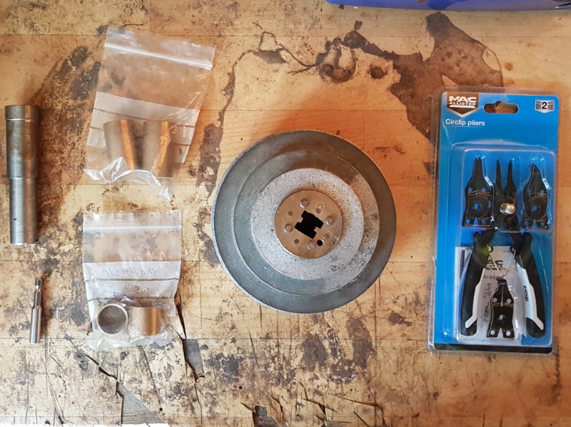

Ergh, gathering everything I need is taking ages on such a small budget, but I'm nearly there.
Bushings are in (got two sets just in case), as well as the circlip pliers. Just wating for the oil to arrive, and for me to get an apropriate piece of bar to use on them. Last months budget went on a desperately needed metal band saw, having been donated quite a bit of stock materials, it was starting to become like the saying "water water everywhere, but not a drop to drink" lol.

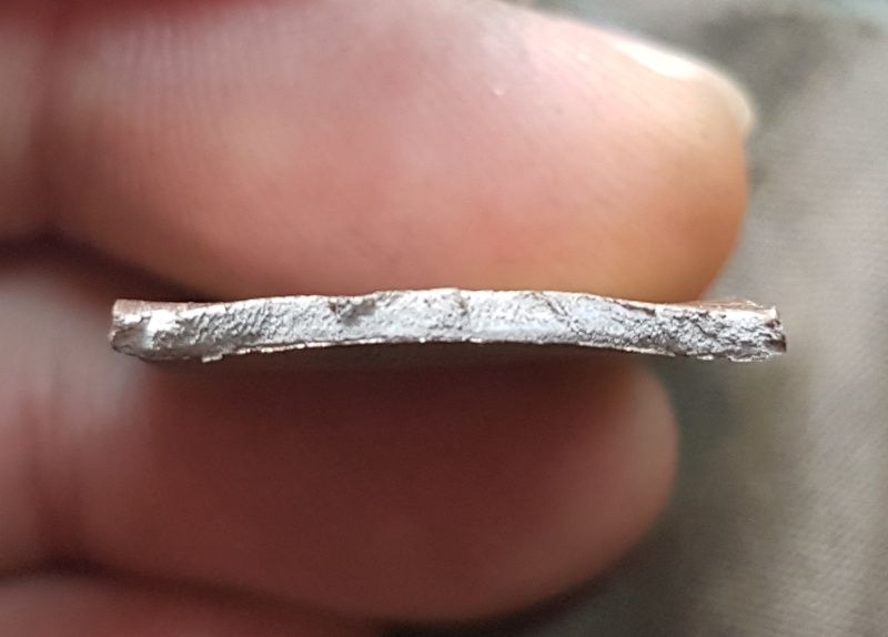

I made small progress with the lower pulley section, though I didn't need a bar, it was so thin on the one side I was able to prise is out. Judging by how stress resistant it was when bending it, I don't think it was an oilite. Since wear can hide and fill the gaps of an oilite, I snapped a piece off along the thickest area to see if there was any evidence of holes or pockets running through the fracture:
As can be seen, it appears to be solid so I'm guessing the other one will be too.

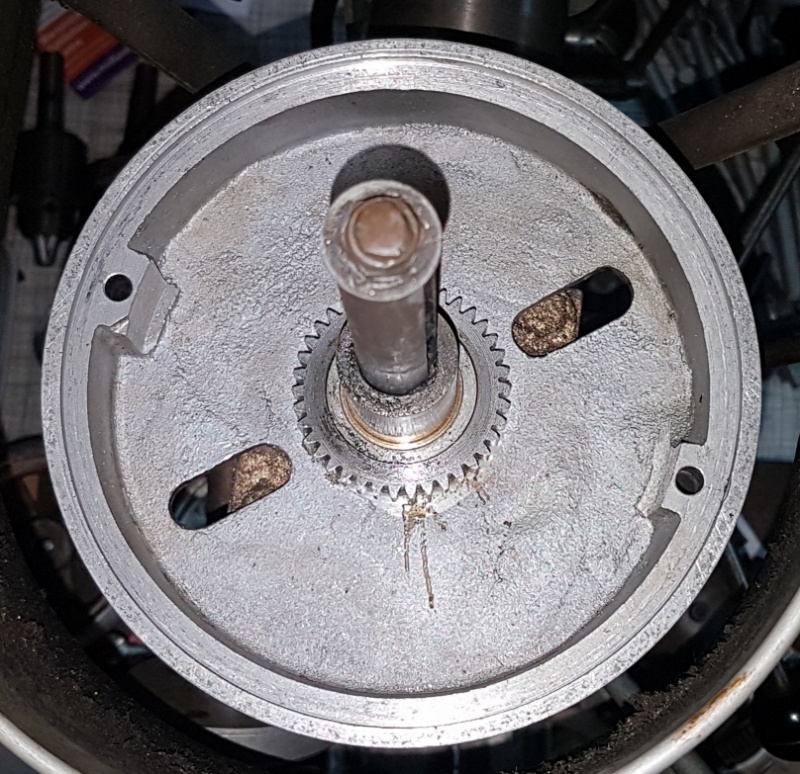

Finally gathered all the necessities and got my degassing chamber down from the loft, which I'll be using to prime the oilite bushings.
After having at it, I finally got the planetary section disassembled but may have hit a snag.
It might just be me but it kinda looks like the bushing butted up to a shoulder, can anyone confirm that?
If it is, any ideas on how to remove the bushing?
If I turn my press bar down to fit the bore from this side, it won't be wide enough to catch the bushing on it's way through. Annoyingly it fits just right if pushed in from the gear side.

From the data of my Mk2 DW the bore on the inner drive sleeve should be bored right through. So the bushes should not be up to a sholder. Is there just a spacer between the bushes?

It transpires I have a Mk1, apparently distinguishable by which side of the machine the quills fine feed is (mine is on the left, Mk2s are on the right).
The inner drive sleeve (thanks for dropping the correct name for it John) and small clusters still need a good clean , which I can do now they're appart, Ill probably get a better idea of what's what then.

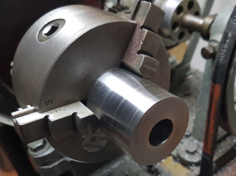

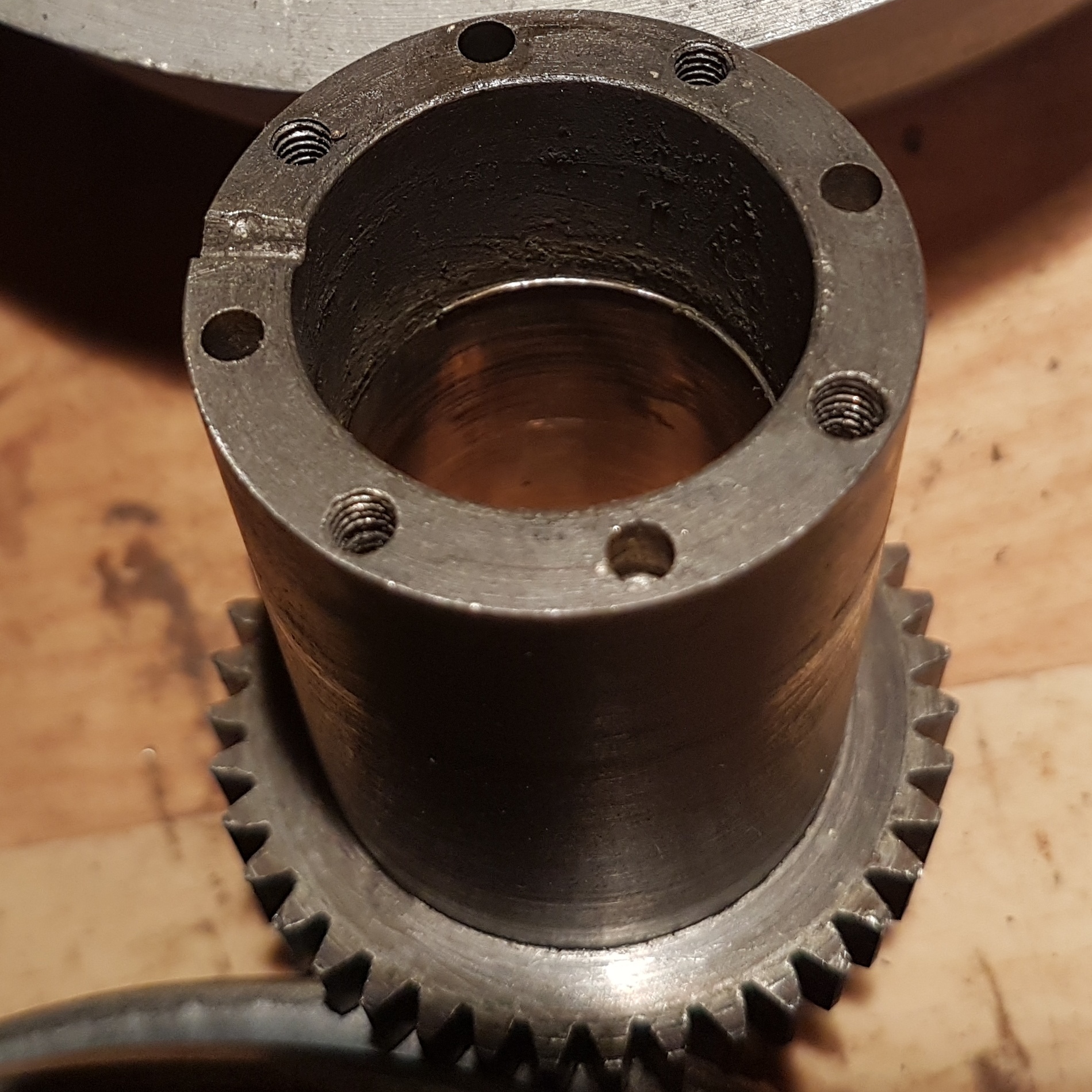

I got the drive sleeve bushing out, but because of the shoulder, I used my lathe to thin the brass enough for me to pull it out with pliers:

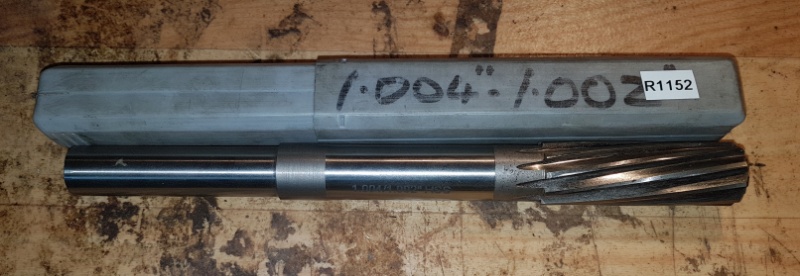

Needed to find a reamer I could use with the limited equipment I have, which held up precedings for a bit. Luckily I managed to score a precision 1" chucking reamer on ebay last week that had only been used once, so I was still nice and sharp and didn't mar the brass.
I'm now making a holder for the drive sleeve. Though not seen, it has a 12mm shank which will be held by a 2MT collet in the tailstock.

out of interest, removing oilite bushing in a blind hole or not......
just use a tap to put a thread in it.......then use a bolt to either pull with a slide hammer or tap (hammer) it out......

I like the idea but I don't have taps and bolts that big which is why I used my lathe

To remove a bush from a blind hole: Make a short shaft, a good fit in the bush, fill the bush about half full of grease, put the shaft in the hole and push it down until it contacts the grease, now whack it hard with a big hammer. The bush should pop up. You may need more grease, and another hit or two with the hammer.
