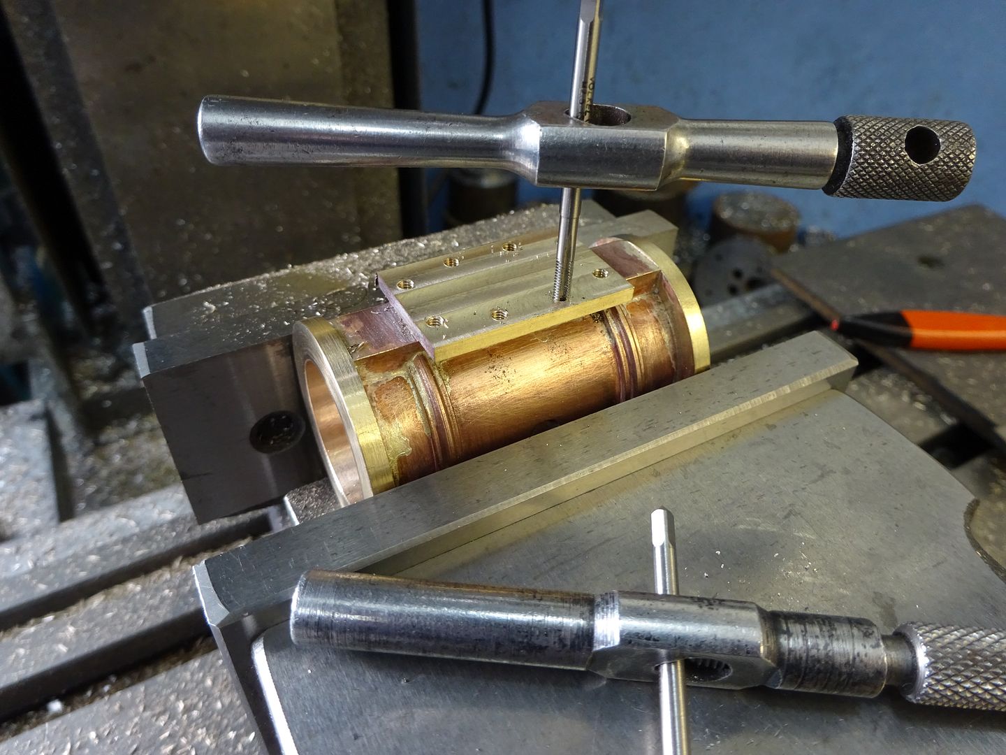

JasonB01/05/2017 18:05:07
avatar
25215 forum posts
3105 photos
1 articles
On other way to protect small taps is to hold them by the shank, that way if thighs should tighten up hopefully the tap wrench will slip before the tap goes ping!
These are M2.5 Volkel ones like I linked to this morning doing blind holes in 2.5mm thick brass
Also has the benifit of making it easier to support the end of the tap with a female ctr as someone mentioned earlier
