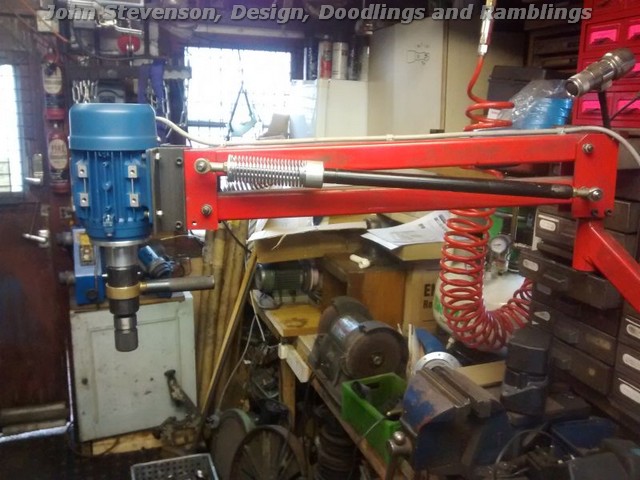

I'd be hard pressed to pick one tool but one I use daily is the tapping head I built.
But last year I converted it from air to electric so I wouldn't have to run the big compressor for doing just a few holes.
I didn't want to mess with the air unit in case it didn't work so I canabilised an unused Machine Mart air drill for the epicyclic reduction box.
It's a three phase motor running off an inverter which gives me variable speed plus instant reverse. Still uses the clutches off the air unit so you can tap a blind hole and it just slips when it bottoms out.
Now can use it for just one hole and being bench mounted it's within reach of the vise so every hole is square.
