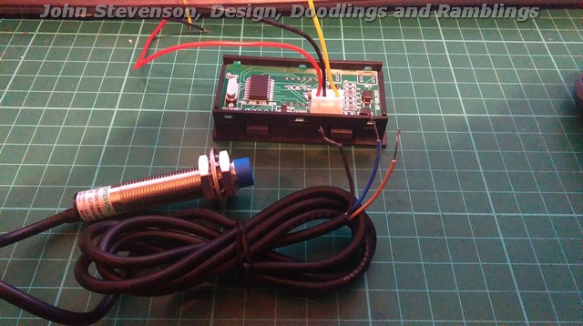

I now see how the thing is connected up apart from one thing. Some people have the set up working without a pull up resistor from the black lead on the sensor to the positive power connector, so should the resistor be included or not?

Posted by Douglas Johnston on 16/11/2015 10:46:49:
Doug
It depends, assuming the Hall Effect has an open collector output (most do) a pull up is required, but these days 99% of microcontrollers have switchable internal pull ups on their inputs that can do the job. But these might not be enabled...
So in short, it depends, but adding one is unlikely to do any harm.

John Stevenson16/11/2015 23:01:27
avatar
5068 forum posts
3 photos
Connected mine up today.
Red on display connected to brown on sensor - both to 12v+
Black on display connected to blue on sensor - both to 12v-
Yellow on display connected to black on sensor.
Magnet stuck on cordless drill chuck, must have been lucky on which way as it all worked first time, no resistors or nothing.
This is a blue display BTW.
