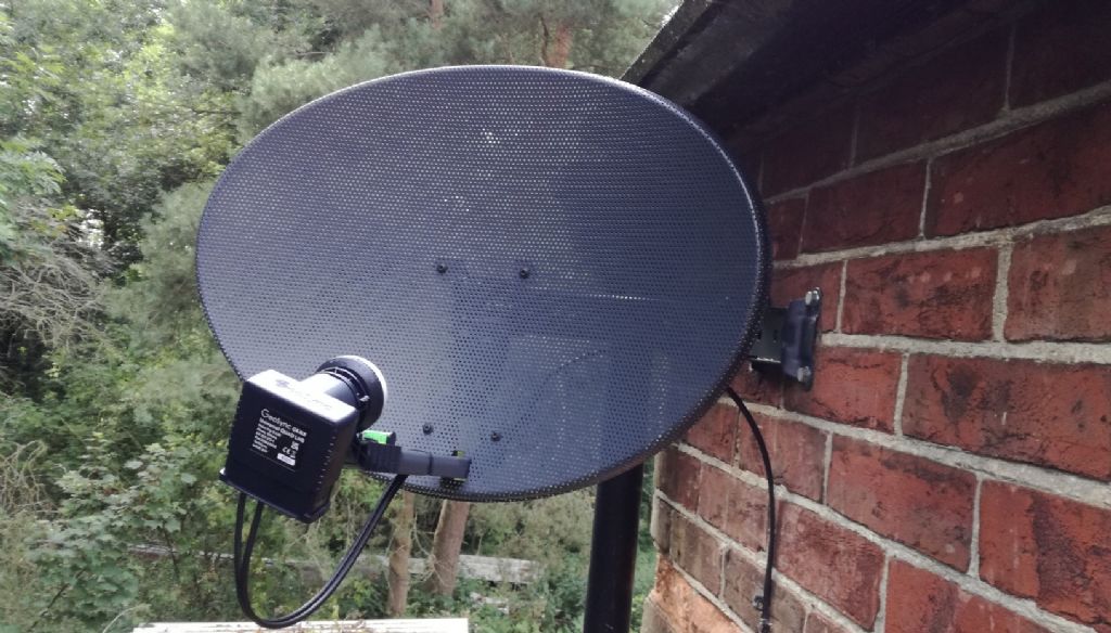

Hi, changed my satellite dish for a new one so I could get the benefit of my new Freesat recordable box.

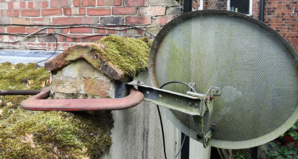

However, I haven't got the new cable into the house yet, so I've temporally fixed my old one in a different location on the same side of the house, but it's a bit lower down, but no drilling of holes was needed.
Don't use these 12" G clamps very often these days, but they are really useful sometimes.

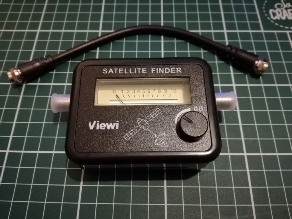

Are they still a thing? I remember setting one up in 2002 after a house move. I'd checked the direction with a compass, but I still needed an SWR meter to get a really good signal.

Hi Neil, the dish came with a satellite finder, I've never used one before, but I've never put a dish up before.
I did measure the angles the old dish was set at, and have put my new dish very close to the measurement I made, so hopefully, the new dish won't need to much adjustment. I took the old dish down without altering anything, and just clamp it to the wall as shown, and the signal strength remained the same and works just fine.
Regards Nick.

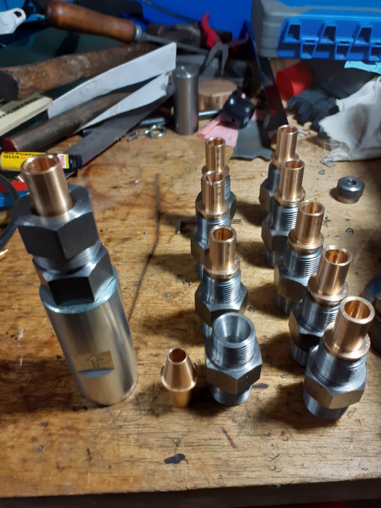

Finished and delivered some lubricator pipe unions to the railway.
The non-return valve is a bought-out item with a 7/8"x14 UNF internal thread both ends. They wanted me to make the LG2 cone to be soldered onto 3/8" dia pipe, plus an adaptor threaded M20 x 1,5 to fit lubricator nuts. The adaptor was made from 1" AF hex EN1A.
So the end that takes the cone is the M20 fine, and t'other is 7/8 UNF to screw into the non-return valve. I made the cones with a 14° taper per side, and the female taper in the adaptor 15° per side, so that tightening the nut will compress the pointy end of the cone and improve the seal at the tip.
There were only 10 to do - carbon steel dies cut smoothly and well, and remained sharp by the finish.
I do this stuff as a volunteer simply because I enjoy the work. smiley
