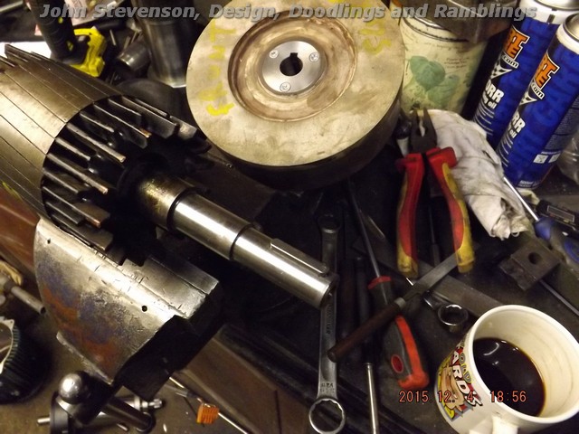

John Stevenson05/12/2015 00:02:36
avatar
5068 forum posts
3 photos

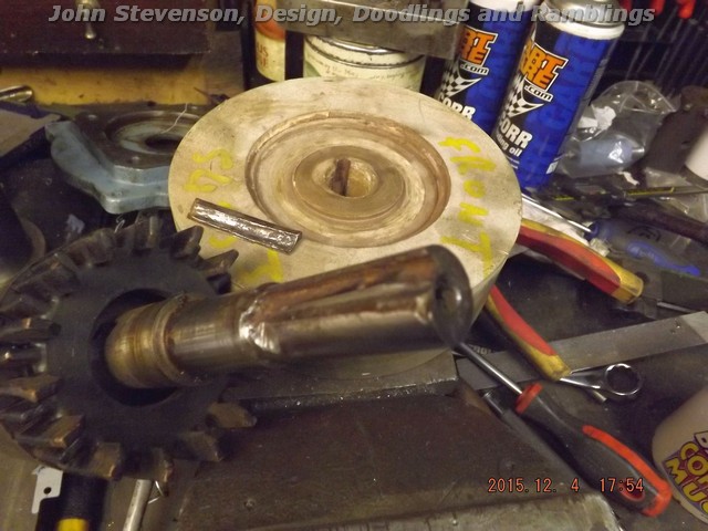

Thought this one was interesting because of the amount or wear on the steel rotor but the resin pulley got off quite lightly.
The rotor was nearly a 'D' shape and the bit on the pulley is what is left of a 6mm square key, that rolled over it's neatly 8mm in one direction but the soft pulley although worm and bell mouthed has come off very well compared.
So bit of weld and whilst it's drying knock a top hatted sleeve up and press and screw into the pulley hub.
Final turn down, polish a keyway and jobs a good un.
