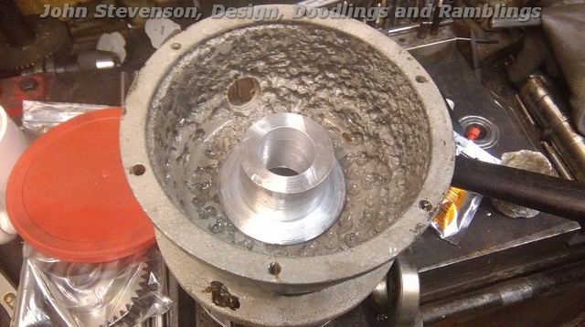

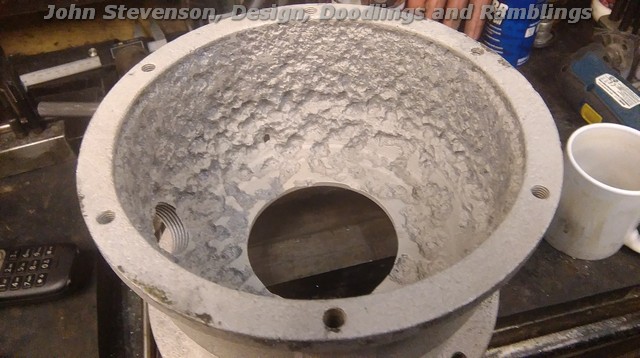

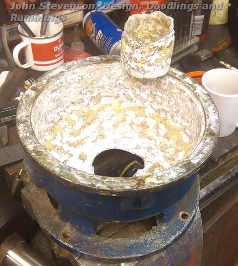

Well this repair might be of interest to Mac users as it was pissing water out.
Long rotor [ no pics - not relevant ] about 3 -4 HP with hollow shaft that drives a fan in a furnace. It's hollow as at the 'fan' end there is a housing that a lance is fitted into and it pumps water down the centre to keep it cool and the water returns back down the shaft and into the housing where it drains away.
Problem is it was leaking water a bit bad so stripped down and this is what was found.
That loose bit should stick up and carry a seal so it needs sticking back. Did actually look at carving a new one out of solid as to complex to use the old one as a pattern for casting. Not a good photo but that is all pure corrosion.
So clean the hole up and send it out for shot blasting.

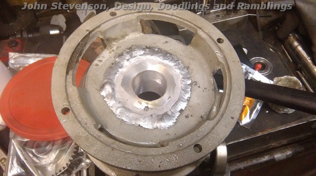

This shows the true level of corrosion, in fact in three places once cleaned it was actually thru the housing. So bit of welding and get this.
And 'tother side.

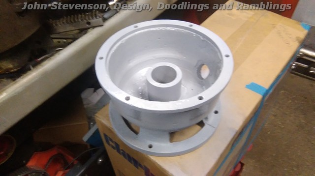

Left oversize so it can be spun up true after welding. All the serious pits punched thru and welded then a coupl of coats of self levelling resin applied to the inside and a clean up.
That looks a tad better and should have earnt enough for a pie and a pint tomorrow night.
