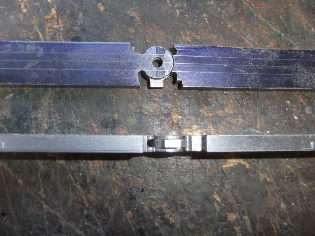

Transplanted another GPO slave-clock movement into a vintage station clock for the railway. This one said on the back that it had a British Jerome Movement but that was gone, and parts of the case looked newer than the 1910s - 20s that were supposed to be the period when those movements were in wide use - but the face and hands (I'm told clockers call them 'fingers' looked genuine enough.
I think this is the fourth one I've done. It's a matter of drilling two pairs of 8BA countersunk close-clearance holes in the face on 44,5 and 17,5 centres equispaced around spindle 'ole. In this case I had to take the case to bits as the round furniture-polish-tin sized GPO slave movement was bigger than its rectangular predecessor, and I had to scrollsaw arcs out the hole in the backboard of the face to get it in.
There were a couple of brass adaptors to be made to deal with differences between spindle drive and finger fittings.
The slave movement looks like this:-
The master clock issues a 3V pulse every half-minute, which energises the electromagnet at the bottom and pulls the pad on the lower end of the lever arm down the right-hand side into contact. The spring-loaded pawl at two o'clock position rides over one tooth of the main wheel without moving it. When the electromagnet lets go of the pad, the (beryllium copper?) spring outside the lever arm returns it outward, the pawl catches the tooth it just rode over, and drives the wheel round one tooth, resulting in 1/120th of a turn of the minute hand (or finger blush) spindle.
The original GPO minute hand/finger is counterweighted on the underside of its tail - presumably to even out the force required to advance it wherever it might be in its trip around the dial - but the 'vintage' fingers replacing it are not, so I've usually found the movement struggles to lift the minute hand against gravity between about twenty-five-to and ten-to the hour. Obviously it can't be left in that state.
I've found I can fix this by tightening the stop screw in the four o'clock position in the pic, to increase the return force of the spring.
Anyway, I hear the clock's now up on the station wall and working well.

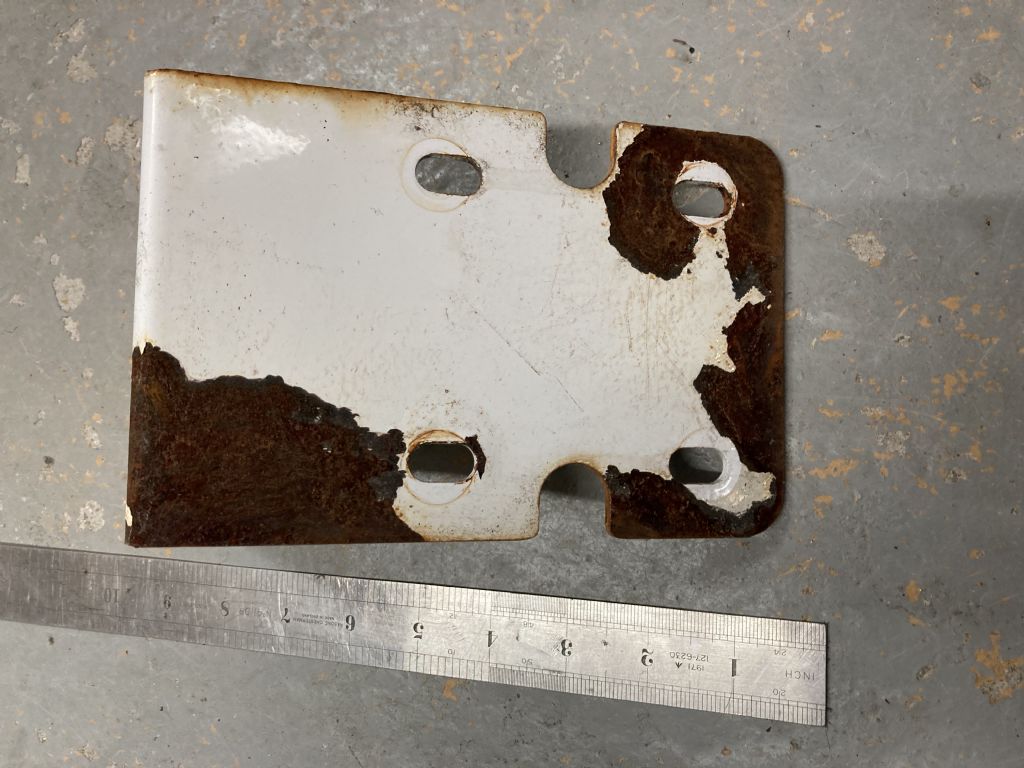

7b966c62-d646-47e2-9863-8a2b91392115.jpegWhat did I do yesterday, I set about restoring the surface finish on a bracket that holds the filter unit used when replenishing the water in my Koi pond. The bracket has been outside for about three years now and has started to corrode badly from the edges. The bracket was obviously finished with a powder coated paint process and anywhere there was a change in section of the metal, ie a sharp corner, then corrosion was forming. Why do manufacturers use powder coating finishes when they obviously cannot contend with weather outside. In the photos, the first one shows the bracket before I stripped the finish off, the second shows the bracket with the finish stripped and shows the extent of the corrosion. The finish was removed using Nitromors paint remover, a horrible process especially when the Nitromors has a tendency to penetrate through Nitrile gloves. Todays job is to neutralise the corrosion as best I can and then etch prime ready for a finish topcoat. My personal opinion is that powder coating should be banned and we should revert to decent spray applied finishing processes.3a74d558-0a90-4f61-954a-95ae3f0bb237.jpeg

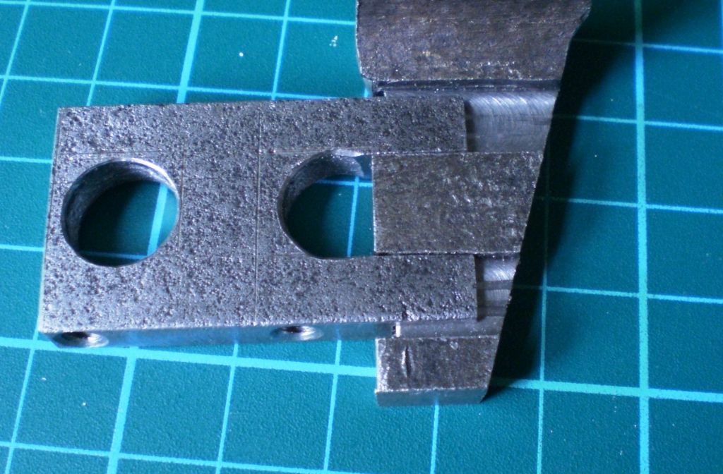

Then when I only had one more gap to cut, I wondered if I could save the one that I cut wrong and so turning to that scrap piece I trimmed a bit more off it and milled a couple of channels on each side, a quarter of the metal thickness deep.
I then slotted the bad end half the thickness in the middle position
These two fitted together very nicely and I drilled and pinned the two slotted sections and and after cutting the last good one off, I silver soldered the joints, this was then cleaned and trimmed and the gap cut.
Today I finished filing a small radius to the inside corners of all the clamps and put all the bolts in.
This is the one I silver soldered a repair and all the bolts had a slight dome filed on the end of their threads.
OK, they are not exactly show pieces, but they work and will do the jobs.
