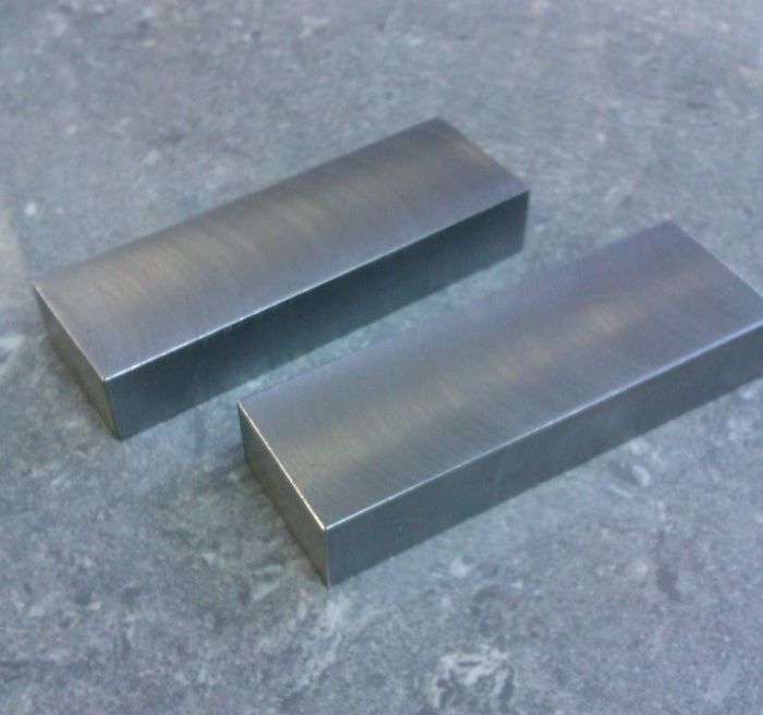

Hi Everyone,
A question for WM-16 or similar owners if I may. Have you tried fly-cutting mild steel (EN3B) and how did you get on?
I've had a go with a standard type fly cutter (2MT) with both HSS and brazed carbide LH cutting tool and I just seem to blunt the bits and the material starts to burnish. I believe I've set the tool geometry correctly on the HSS bit and have tried speeds ranging from about 400RPM to 800RPM or so. Depth of cut was never greater than 0.2mm and slow, steady hand feeding as I don't have an auto-feed yet. Everything that needed to be locked down was done so.
Thanks,
Ed.
JasonB14/04/2014 17:31:15
avatar
25215 forum posts
3105 photos
1 articles
I have a similar sized X3 and get a reasonable finish from the flycutter. Nothing special just a cheapie set of 3 with 1/2" shanks, 1/4" HSS but run at what revs seem right. Not the crispest of photos but thats 1" x 1/2" mild steel cut down to 7/16". Hand fed with a dab of soluable oil applied with a brush.
Edited By JasonB on 14/04/2014 17:31:47
Rik Shaw14/04/2014 17:53:51
avatar
1494 forum posts
403 photos
Ed - I fly cut regularly on one of these machines and get nice finishes mostly using HSS. You do have to practise with getting the tool ground correctly though. When you have it right the the tool bit hisses as it cuts and leaves a lovely finish. It's hard to give any further advice without seeing how you have ground your bit which of course, is not possible unless you live near me.

Neil Wyatt14/04/2014 18:23:38
avatar
19226 forum posts
749 photos
86 articles
400-800 rpm seems very high for a fly cutter, unless it is a very small radius.
In theory the 108rpm for a 100mm blank in the picture above can be turned on its head - 108 rpm for a fly cutter with radius 100/2=50mm.
I run a ~ 35mm radius fly cutter at about 120rpm.
Ed Duffner14/04/2014 21:15:37
863 forum posts
104 photos
I had another go and it seems to have improved. I find it a bit difficult grinding an even radius on HSS but think I have it now. I also just looked at my copy of Peter Wright's Model Engineering Foundation Course (comparing his photo of a cutting tool) and I have not included enough clearance angle for the edge that rubs against the cut face, so I was basically cutting a slight chamfer and the bit was trying ride up over the cut originally.
Also in the book, it has a table for speeds but the printer has pushed text out of line and it's a bit unclear as to what the speed for BMS is. I just tried 250RPM but that felt way too slow. Then found 525RPM to be ok and I also reduced the amount of tool bit protruding from the cutter.
Here are some photos. This as a piece of mild steel about 5/8" x ~4.5"
Edited By Ed Duffner on 14/04/2014 21:17:52
Neil Wyatt24/04/2014 21:42:23
avatar
19226 forum posts
749 photos
86 articles
Hi Ed,
In Peter Wright's table BMS should be one of the first 'group' with copper, gunmetal etc.
Fly cutting is REALLY slow. I'm talking paint drying slow. I'm guessing from the marks that your cutter has a diameter of about 2". I'm amazed you haven't simply burnt the end of the cutter off.
If you have the patience ry running at about 100 rpm and turn the handwheel really slow so it advances a few thou between cuts. You should then start getting the silky 'flycut' finish you want.
If it feels too slow, you're feeding too fast.
Of course, YMMV, but I'd be interested what speeds other use with what size of flycutter.
