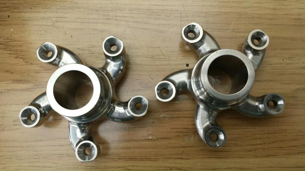

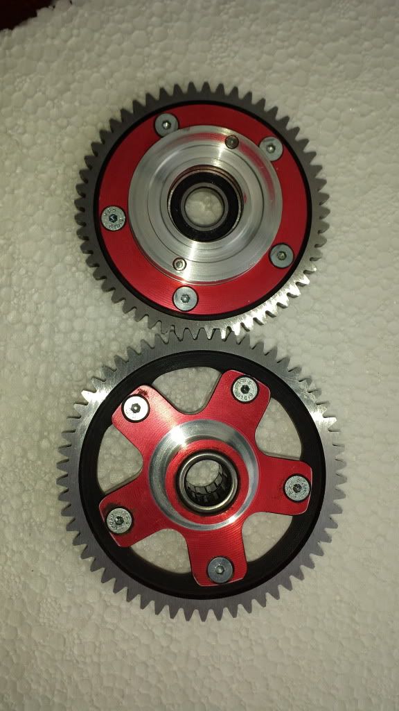

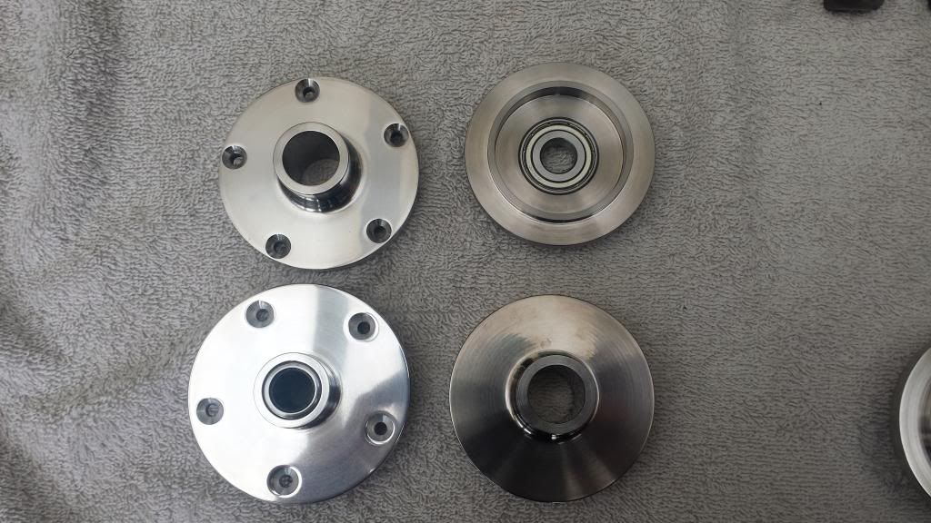

Dean Jeffery 116/06/2014 08:45:49
28 forum posts
Cheers guys
The first IMG 4 items the top left sizes are
OP1
1 face up
2 turn dia from 75 to 69.5 +-.1 will be fine to 22.5 long
3 turn 69.5 dia to 24.5 15.5 long .1 tol
4 drill to any size the machine can take to around 17mm 35 deep
op2
turn round
1 face to length 32mm
2 turn 75 to 49.95 +0-0.05 10 long
3 turn 49.95 dia to 21 long +.1-0
4 bore for a bearing 18 dia - 0.025 32.5 long
Turning on a lathe with just 1mm cuts myford ML7, so thought a CNC would handle this just as good. Milling was also just 1mm rough cuts. Finishing was done with a ball nose taking very fine step over cuts to get a smooth finish.
On a scale this is not going to be thousands off, hope so but doubt it.
Mike if you turn 2.6kg in 2 mins down to just 60g, so i need more info regarding machining my parts.
Software i know you can pay 7.5k plus for it, and work pays 5 times that just for the license a year. But the part is not very technical just basic 3d, on another forum a bloke replicated it in just 15mins but used solid works or solid cam
The £30-£40 an hr was just for turning from to local firms, 1 i used to work at was £30 an hr.
I know it's not easy just thought or hoped it would be possible to get these done at home, and based the turning on the turning i did on the manual lath. If these can be made at home in under 3 hrs i can make good money on the orders i have just now, i have 2 parts going to the states for testing to make sure they are bullet prove. I have no doubts about them been has though they are replacing aluminum, just a different design.
The allo 1 weighs 86.5g the Ti comes in at 89g but using Ti bolts takes this down to the same weight as the alloy.
Cheers
