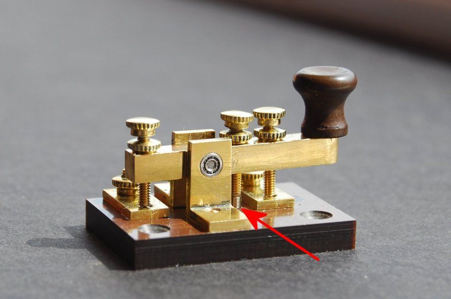

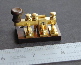

On the subject of small magnets, I used a pair of them 2mm dia by 3mm long, with opposing poles instead of a spring on a miniature Morse key to keep the contacts normally open.
