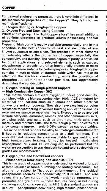

Ian S C08/03/2014 10:57:42
avatar
7468 forum posts
230 photos
Got some specs here, hope it's readable. Ian S Cimgcopper info (360x640).jpg
