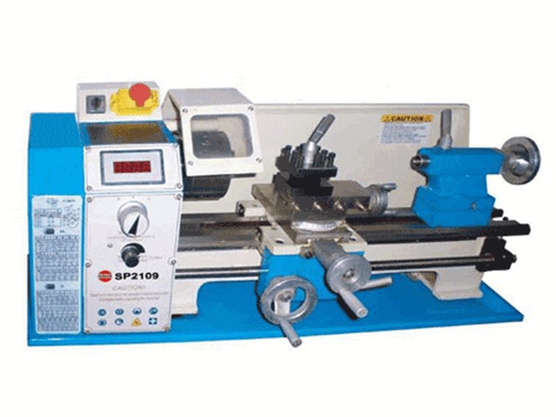

I think I have got it. I posted a picture of my lathe in my Album. Here it is.sp2109_01.jpg

I am trying to make small parts they are called case neck expanders used for opening up brass cases to precise dimensions. The work needs to be about 1" long and .313 along the length with a collar stepping up to .317 at the chuck end. The measurements need to be precise and I need a smooth ripple free finish. The finish is proving to be a challenge. I am using 1/2" silver steel bar taking approx. 5 though cuts at about 600rpm until I get some were near the required size .317 then I am slowing the work and taking very small cuts to get to my required dimensions a portion of the bar is left at 1/2" diameter I just part it of to the required length .(Now I have mastered parting off) up to now I have wasted a lot of silver steel bar. But its all a learning curve.
The parting off problem was mainly due I think to the tool post not being rigid enough I was using a not very good quick change tool post I changed back to the original tool post and set it up with a parting tool holder and blade and some good quality carbide inserts and the problem went away.

You want to be taking bigger cuts and running the lathe faster, don't slow it down for the last few cuts, speed it up if anything as you are removing less material.
It may also be that the feeds on te lathe just don't go low enough to get a super smooth finish in which case honing as Michael suggests may be the answer, Bit of Emery cloth backed with some MDF works well for that final sizing operation.
