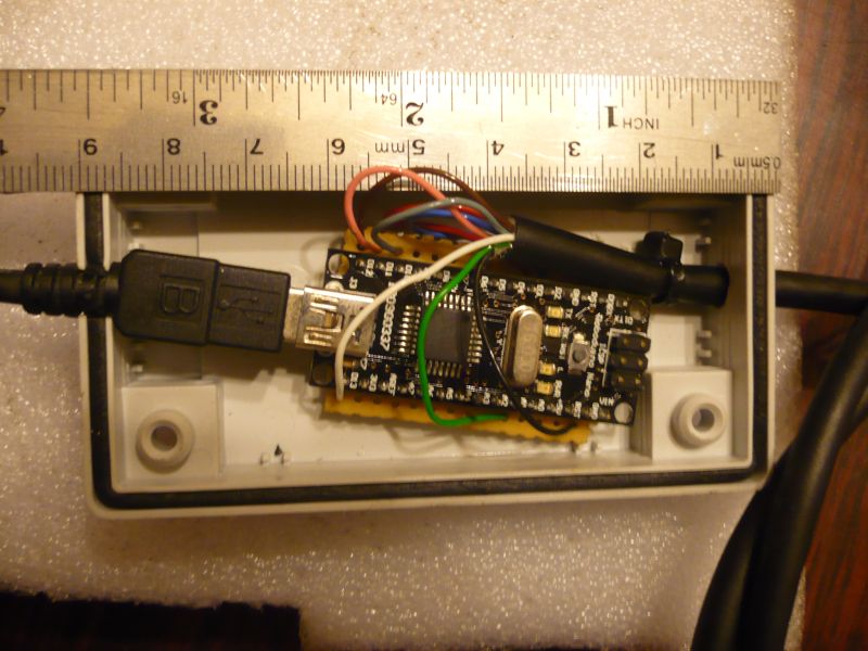

I have a Nano to run a rotary table.
This is programmed from a laptop and then the laptop is used to run the rotary table, bit of a cheap mans division master and other than soldering a few wires on it's a simple build.
John,
A question if I may: how is the Nano connected, direct to the stepper?
Regards
Paul

Just a quick reply, gotta shoot up to Machine Mart to get some castors, the wheel has fell off the pram.
The project is just a small part of a larger project that controlled a very expensive camera system and was paid for by a customer.
I got the right to distribute the simple rotary axis part. I post later tonight in depth but I can share all the files.
Probably put a new post up later.
Paul,
The Nano or Uno [ both do the same job ] has a USB cable in one end which feeds 5v and signal to the Nano
Other end has 3 wires coming out step, direction and ground to go to a stepper driver.
As I say I'll post more when I'm welded the the armchair tonight.
