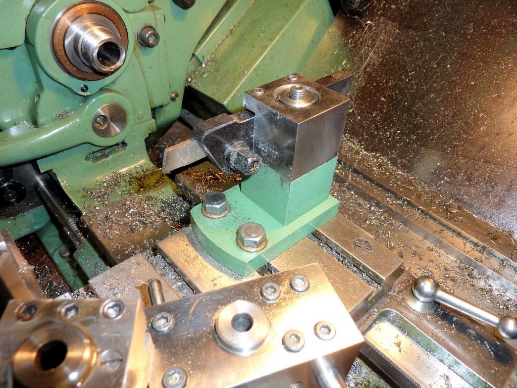

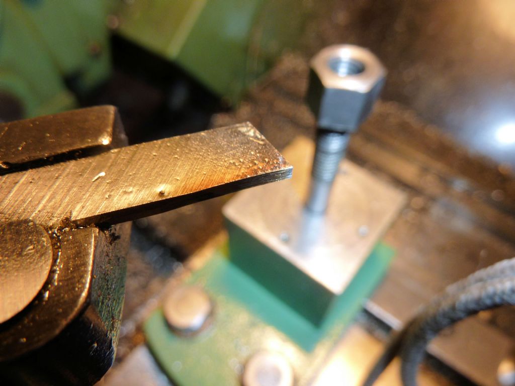

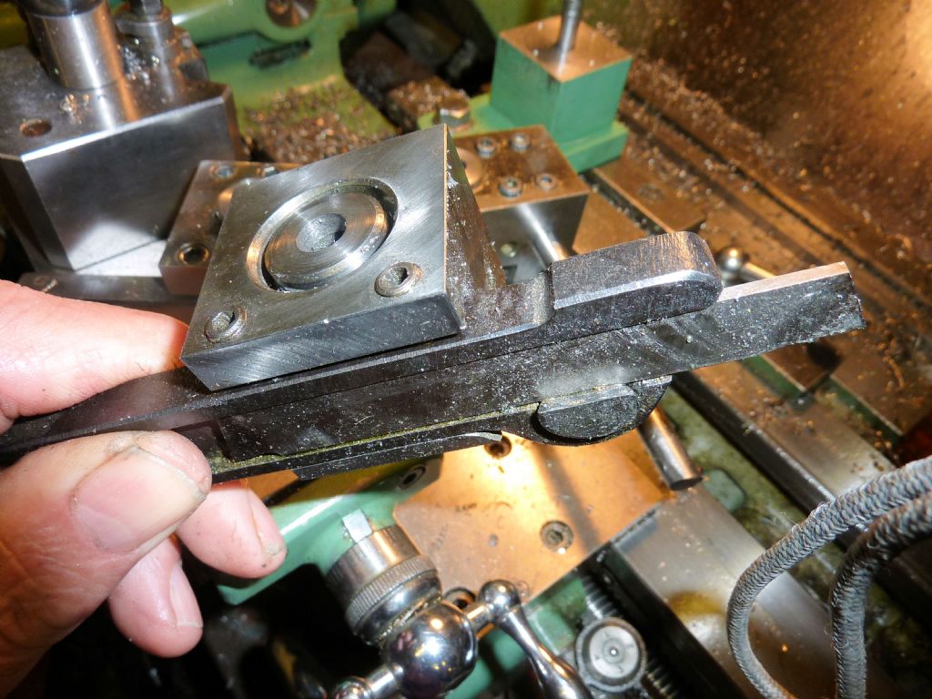

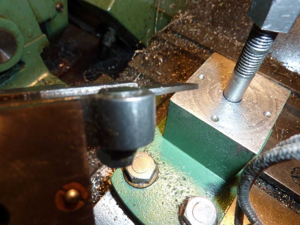

Chris Heapy14/05/2013 16:25:11
209 forum posts
144 photos
To the OP, I took some photos by way of a better reply.
This is my rear tool post, which I made many years ago:
...and some of the tooling made to fit it:
This is the Eclipse 1/16" bade parting tool:
Difficult to photograph, but this is the cutting edge of the 1/16" blade:
This is my 3/32" blade parting tool - like yours I think:
...and more attempts to image the cutting edge of the 3/32" blade
I am not saying the cutting edge shape is either 'correct' or recommended - only that this is what I find works for me with these particular tools on my S7B.

Grizzly bear14/05/2013 21:22:48
337 forum posts
8 photos
Chris H, Nice work that rear tool-post & fittings. Good photos too. Regards, Bear.. P.S. How do some correspondents get the return key to work?
