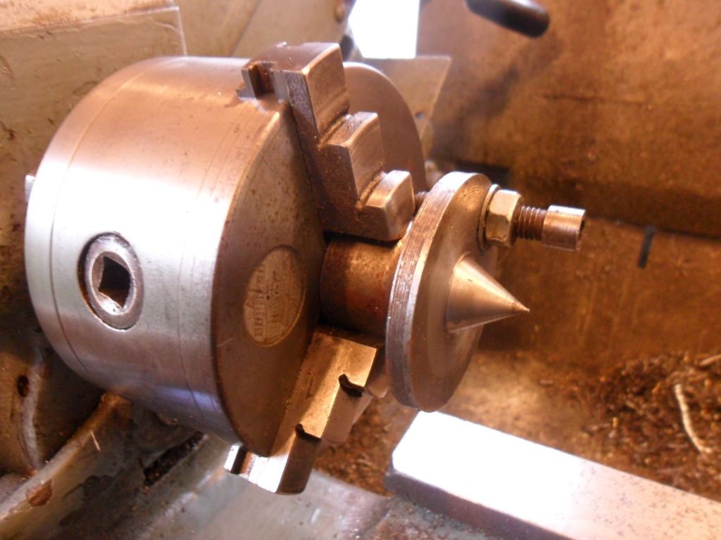

I always turn the dead centre in the head stock before use. That way I [know] it is perfectly concentric.
Just a light trim cut.
Soft dead centres are easy to make; often I just pop a small end of parallel sided steel I use as a centre in the three jaw. skim the point to make it concentric and use.
It saves time compared to removing the chuck and fitting the nose plug and a centre, although that method has less overhang.

soft centreHi
Drifting away from the thread a bit . You can use 2 dead centres on a cyclical grinder. Also as john says you can turn a centre in a 3 jaw chuck and save it all it needs next time is a light trim
Nobby
