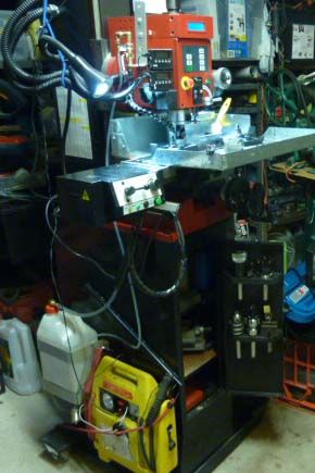

Hi Gary, My SX3 came with its own factory made base which is 870mm high. This is a comfortable height to work with. I only have a small corner of my garage to use as a workshop and have mounted the base on wheels so I can push the mill out of the way when not needed.

David Arthurs21/02/2013 04:55:21
3 forum posts
Posted by Paul Lousick on 03/02/2013 22:09:52:
Hey Paul,
I'm a new member, and just ordered my first mill today, an SX3, along with the SX3 stand. If it isn't too much trouble, would you please post a clearer pic of exactly how you mounted the wheels to the bottom of your SX3 stand? Thank you very much!
Edited By David Clark 1 on 24/02/2013 10:35:23

Good to know Ian, thanks! I already have the stand coming though, so I think I'll just resign myself to the idea that I'll be using it, and probably putting castors on it. I am not yet equipped to weld, but that will likely change by the summer! Thanks again!

This how I made the trolley for my SX3 mill. Easy to move and sturdy to use.

Wow, Paul, thanks so much for going to that trouble! It appears that you have added something to the side of the stand, on which you have affixed your clamps kit. What is it? Also, those look like plastic wheels. Are you at all concerned that they'll break? Thanks again!

The clamp kit came with the red plastic rack which already had holes for mounting. The mill only weighs 200kg which is only 50kg per corner. The wheels are rated at 90kg each.
