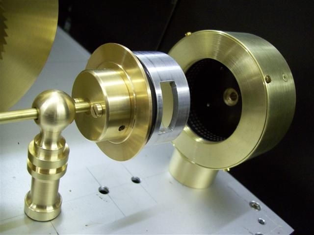

![]() 2747 forum posts 123 photos | It looks beautiful! I don't profess to know what the shafts and gears (and flywheel?) do, Oh! I see the small hour drum now I presume the holes in the drum are 60 'wide'? so you have seconds round the edge. how is the hour displayed? Looking at what you have already made I don't think you need to do any more learning.

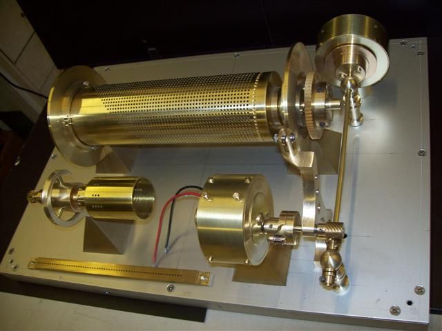

![]() 508 forum posts 98 photos | Thank you one and all gents for the very kind comments. I have a confession to make, I did not make the helical gears that drive the seconds unit. They are way beyond my skill level, I did make the ratchet wheels on a home made dividing head which was also used for drilling all the holes, and all those ops were done on my X1L mill. The helical gears came from some M.O.D. scrap,and the rest of the clock has been made from many grades of brass, all of which came from the scrapyard. I will do a rough sketch of what the finished item will look like, but with more hospital visits due with my wife it may be a few days yet. Ian, all should become clear in the sketch when i get chance to do it. Cheers Derek. P.S. I honestly never thought of the music box connection, but i see it now. |

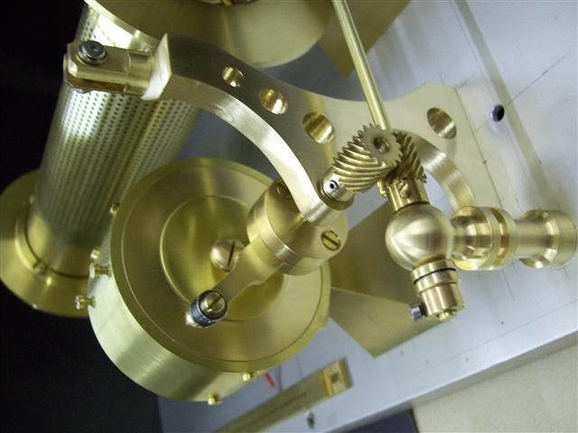

There would appear to be a bit of interest so here are the latest bits. The first pic shows that i have now fitted the lever from the motor to the ratchet on the min's cylinder.
Next one has the bar that will hold the fibres with one fibre in place, the other end of the fibre is shown in a piece of black perspex to give some idea of the effect i am trying to achieve. Cheers Derek. Edited By magpie on 10/01/2013 17:32:11 |

No matter what i try, posts that have pics never come out the way i intended. These are all in the wrong order, still you get the picture ( pun intended ) i suppose. Cheers Derek. Edited By magpie on 03/02/2013 22:40:23 |
