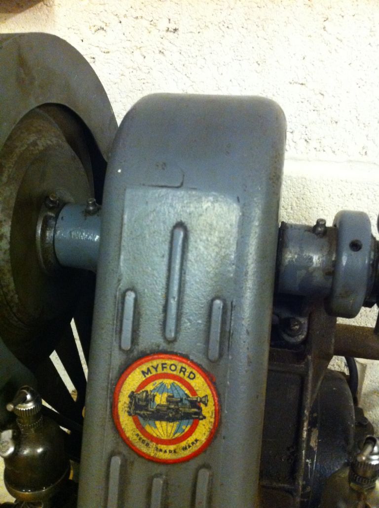

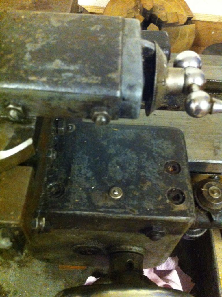

My ML7 has raised nipple oil points on the countershaft / drive area but almost flush oil points on the saddle / slides etc.
I don't have an oiler yet - do I need two to cope with the different geomety of the points as raised nipple types on the saddle would be a pita + I can't see an easy way of removing the old ones as they are flush with no means of applying any torque to them.
As ever, help appreciated.
Simon.

Some photos to see what I mean:

Hi Simon,
The nipples on the countershaft are not for oil but are grease nipples and are intended to be used with a grease gun. The simplest push type has a cupped end to fit the nipple and the pressure of pushing the telescopic gun seals and pushes in grease. There are ones such as the Wanner lever gun which clamp on to the nipple and have to be released after use. The latter are too high pressure for this application a simple push type would be best. I don't know what grease is recommended for this application as I have not had anything to do with Myfords for 40 + years.
The 'flush' ones are ball oilers, just push the nipple of the spout of the oilcan onto it and squeeze the trigger. The ball is sprung and will let oil in but keep dirt and swarf out.

Simon B27/11/2012 09:04:24
avatar
12 forum posts
3 photos
Terry,
Thanks for this - I was under the understanding all points were for oil and the only applicatrion of grease was onto the gears directly? Have I got this wrong?
Simon.
roy entwistle27/11/2012 09:25:15
1716 forum posts
My hand book says Esso Nuto H32 for all nipples Oil of viscosity SA30 on all sliding parts Feed Screws lead screws etc No mention of grease anywhere

John Stevenson27/11/2012 09:34:31
avatar
5068 forum posts
3 photos
Sorry Terry, they are oil nipples, they have no undercut for the end to snap on.
It's been a bain of every Myford owners life that the OIL gun supplied with a Myford leaks when filling this nipples, given is a metal to metal push fit it's hardly surprising.

Terryd27/11/2012 10:52:56
avatar
1946 forum posts
179 photos
Posted by John Stevenson on 27/11/2012 09:34:31:
John S.
Hi John,
Having looked closer I see what you mean I thought that they looked like button headed grease nipples. My eyes take a while to get working in the mornings these days sad. Perhaps it may be an idea to swap for grease points rather than oil?
Regards
Terry

roy entwistle27/11/2012 14:04:02
1716 forum posts
Terryd I think you will find the countershaft runs in 'oilite' bushes the name suggests oil not grease

Gone Away27/11/2012 16:54:11
829 forum posts
1 photos
I picked up on that when you mentioned it some time ago David and it always worked well for me with a scrap of soft kitchen towel ..... thanks.
Based on another thread, I've recently replaced what nipples I can with regular, brass flip-top oilers which has simplified things enormously.
Robin teslar27/11/2012 18:00:57
avatar
127 forum posts
8 photos
Posted by Sid Herbage on 27/11/2012 16:54:11:
Hi Sid
How did you gat the original spring ball oil tips out? Are they screwed in or a push fit. The flip top oilers sound entirely sensible.
Oh BTW, the photo up top shows what looks like grease nipples on the counter shaft. I dont think grease is a suitable lubricant, too high a speed on plain bearings
