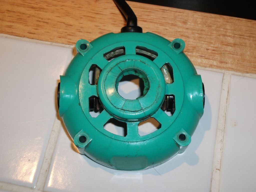

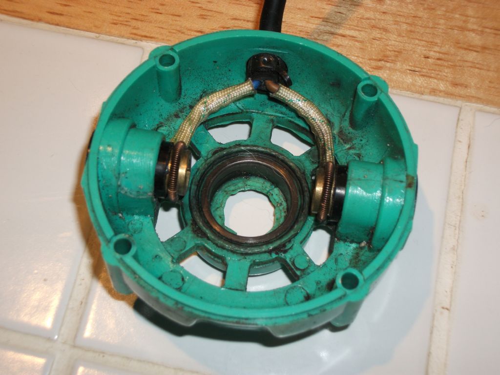

graham bartram15/07/2012 21:45:06
4 forum posts
2 photos
lathe motor cover 002.jpgHi,
Please see photos - I'm looking to buy a plastic end cover for the motor of the cl300m. If anyone out there has one they'd be willing to sell, could you please let me know? Cheers, Graham
Stub Mandrel19/07/2012 21:02:06
avatar
4318 forum posts
291 photos
1 articles
Hi Graham,
I have converted my CL300M to use a 1/3 HP Hoover Fractional motor, so I have exactly what you need!
Send me a personal message using the'message member' function and I will give you an address to post me a suitably large stamped jiffy bag, and you canm have it for free.
