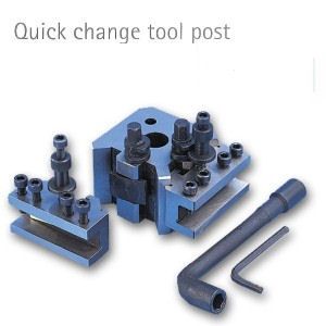

What QR toolpost and where from

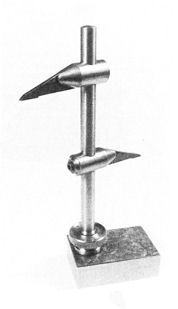

Should the tool tip be at the ctr of the work (round bar) or off ctr
David Littlewood15/03/2012 12:19:06
533 forum posts
David,
You are quite right, 10 mm it is. I must have been having a senior moment; should have gone downstairs to check. Apologies to the OP.
As for the tool tip, dead on centre height (centre of bar) is best in most circumstances. For very fine cuts, avoid going above centre height or the tool will rub. Very slightly low is OK, but leaves an annoying little pip in the centre when facing. Making a centre height gauge tailored exactly for your own lathe should be one of your first tasks when acquiring a new lathe.

Ctr height guage, any pointers please?

Tool Height
CENTRE HEIGHT GUAGE & DICKSON TYPE TOOLPOST
ON MYFORD S7
Edited By NJH on 15/03/2012 17:13:52

The toolpost, is the tool height adjustable?
David Littlewood15/03/2012 18:09:15
533 forum posts
The above design seems fine, but better still to have an additional finger reversed to allow setting of upside down tools (can be useful for boring tools).
The toolholders' height is indeed adjustable. Slacken the cap screw at the very top, loosen the clamp, adjust the knurled positioning bush until near-correct, retighten clamp, retighten capscrew, check against your height gauge. This will almost certainly show it is not quite right, and the position does tend to move a little on tightening, so repeat as necessary until it's spot on, and then check by taking a facing cut, which should just not quite leave a pip. Sounds laborious but (a) once you have done it a few times it becomes second nature and (b) once you have done it you can leave the tool there indefinitely. That's if you have enough holders to have one for each tool you use and a couple of spares for one-off tools. After a few years you probably will. It's a whole order of magnitude faster and better than fiddling around with spacers in conventional toolposts, and as for 4-way tool holders, yuk_spit.

NJH15/03/2012 18:13:31

Yep
The interface between the tool holder and the tool post is essentially a dovetail, or maybe more correctly a series of dovetails, which allow the holder to move up and down on the toolpost.The holder is locked in place by tightening a ( removeable) box spanner on the hexagon head next to the toolpost clamp (on the right) which pulls the two items closely together. With this freed and the top socket screw on the toolholder loosened, the height of the tool holder can be set by moving the knurled knob in the appropriate direction. Once done the hexagon is tightened and the setscrew on the tool holder also tightened thus locking the position of the knurled nut. When the time comes to change tools simply undo the hex nut , remove that tool and holder and replace with the next tool. Do up the hex nut and continue.
It takes a little while to set up all your tools and holders but once done it increases productivity no end! Oh by the way you can never have enough holders - at the last count I think I had 16 - in one of these I keep a clock guage - very useful when setting work in the Grip-Tru or 4-jaw.

Norman, where did you get the tool post from?

As Phil said above you can buy a QCTP from any of the online suppliers such as RDG, Chronos, Warco (ad in the RH column on this page), Axminster Power Tools etc. etc. There are several good tool suppliers if you Google them.
These suppliers also sell sets of pre ground HSS tools which gets you started without having to grind your own initially. you will need a small grinder (Machine Mart) and a diamond slipstone to touch the tools up and keep keep them sharp. There is a lot of information on the internet about lathe tool shapes and keeping them in good order, just do a bit of research there.
Here are a couple of pictures, one of a 'Dickson' type toolpost but there are other types to consider. It may be worth visiting one of the suppliers on an 'open day' such as Chester (Google) or Warco, or visit a local Model Engineering club (see internet or Directory for a local one) where you can get hands on and advice. Also the one pictured has the capacity for two tool holders at the same time so you can swing a second tool into place easily, some only have capacity for one at a time which means changing the holder more often and is less convenient in my opinion but others may disagree.
The second picture is of a centre height gauge from a George H Thomas design - his book is also very good and is usually available from local libraries (if not they will get it for you). It is called "The Model Engineers Manual" and makes a good read.
