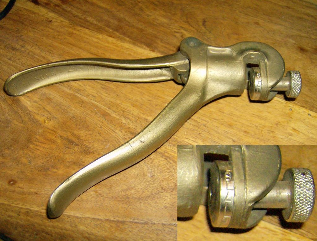

My stepson found this tool in a box of various items he had from an ex-plumber.
A knurled, spring loaded nut at the top allows adjustment and locking of a cam which varies in thickness, numbered 4 at the narrowest and 12 at the thickest setting. The higher numbers are closer together.
Pulling the lever presses a spring loaded anvil with a slot in it against the cam, then a wedge or blade rises up in the slot against the cam as well.
There are marks inside the handle, but all I can read is "Made in England".
I immediately guessed it was a wire stripper, but this theory falls down as (1) you need to pull the wire the wrong way and (2) stripping anything other than a small wire needs the strength of Samson. The reason is that it works there wrong way for a stripper where the centre should be a sprung part to grip the wire, and the outside parts should be the blade forced up to cut the sheath.
Can anyone shed some light, noting the possible plumbing connection?
Thanks

Looks like a tool for setting the teeth of hand saws. Before hardend tooth saws were available it was a carpenters job to first file the teeth with a triangular file and the set each tooth altenativly with this tool.

An easy one for my first posting; this is a saw set.
Used to set the teeth of a wood saw usually after sharpening

It is a tool for "setting" the teeth on a wood saw. As you can see the amount of set can be adjusted. You go down one side of the saw squeezing alternate teeth. You then repeat this on the other side setting the ones that you did not do on the first side. I think I may even have one somewhere.

The numbers relate to the tpi of the blade eg smaller tpi needs less of a bend to set.

Back in the days when I was a "wood butcher" it was my job as an apprentice to sharpen the hand saws every week usually on Friday afternoon. Later, I always sharpened my own saws and always set before sharpening. This was to avoid the setting tool coming into contact with newly sharpened teeth. I would set the teeth one number less to compensate for the metal removed during sharpening and the teeth were then carefully guarded and placed in the toolbox and if handled carefully, only a light touch with the file would be required to keep the saw sharp. Setting was only carried out after four to six sharpening sessions.

I looked very carefully inside the handle and it says "ECLIPSE" in the sort of faint letters you can only read when you half expect what to see... but buried under the junk at the bottom of the toolbox was a battered card box with a picture of it - "Eclipse 77"
