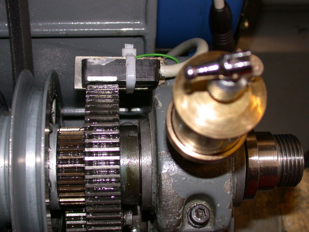

Les Jones 129/11/2011 19:33:11
2292 forum posts
159 photos
Hi Steve,
If you don't mind building at tachometer yourself there is a design on my website that may suit you.
I did submit the design to MEW about two years ago but I have not heard of any plans to publish it.
There is a picture of how Roy Stark mounted a hall sensor on his Myford in "My photos" in the album "misc" (For some reason this photo will not insert into this reply.)
Les

Les Jones 129/11/2011 19:51:06
2292 forum posts
159 photos
Here is the picture that would not insert into my last post. (After loading into paint shop pro and saving a copy of it.)
Les.
