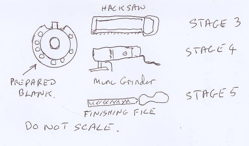

Here's a tongue in cheek challenge!
How would you machine the part shown below? It's a true bevel gear pinion, 10 teeth, 6DP, 3/4" face width. The largest OD is just under 2".
As illustrated, the bevel gears are machined in aluminium; the final parts will be in cast iron. Note that. after deburring, the gears mesh together perfectly.
So, what machines would you use, what accessories might be needed, and what tools would you use or need?

I'd use my grandpa's old hacksaw and finish the teeth off with a nice rat tailed file I bought in Woolworths about 30 years ago; I can work to about 2/10 of a thou with that file, who needs CNC

Horizontal milling machine with a dividing head on an angle

Depends on what it is for - but I have a couple of bevel pinions for the TE to do - a 4" Little Samson in 6DP. I'll do them in cast iron as a parallel depth bevel - see Ivan laws book. I will also do the bevel ring gear like that too. He does do a cast version which I used on the 3" LS, but I fancy a change
With a GHT VDH the blank  roll is easily achieved using the plate wheel.
No CNC at all - fully manual devised during WW1. Aint exactly difficult with a dividing head and mill.

A few options.
Probably the most accurate is to sent it to the local gear cutters to be cut on a Gleason Bevel gear cutter. that might be classed as cheating though.
Next is to mill it on a milling machine with universal dividing head that can tilt, like the BS0 and BS1 and take 3 cuts, one on centre, one above and one below centre. This does entail some hand filing of the addendum from half way down the face width to get to run correctly.
Followed by what MGJ says and cut to constant depth, again three cuts but no hand finishing. Only problem with this method is you have to do the pair, a constant depth bevel will not run with a normal bevel.
Then we get the CNC option, again needs tilting dividing head driven by stepper, now I have had to do a bit of guesswork here as Andrew hasn't given any detail on the mating gear and this controls some of the parameters so I have taken a guess at a 10 tooth driving a 45 to get a pitch angle matching the photo.
Literally 10 minutes work filling boxes in gets me this.
This drawing now gives me all the information I need and 5 minutes later i have the code for this [ which i don't need to look at, just load it and Mach3 tells me it will take 1 hour 58 minutes and 53 seconds to cut this.
And this on the little KX1 mill, run time just below the screen.
John S.

Forgot to add in the previous post that the program is expecting a cutter of max diameter of 0.1786 so i programmed a 5/32 as being the nearest stock size but could have used a 4mm or a 4.5mm cutter so no expensive tooling needed.

A shaping machine and some hss tools, with the blank mounted on a dividing head which could be set over at one end for the bevelly tapery bit.
Do the narrow cut.
Set over left. Do the left hand cut
Set over right. Do the right hand cut
