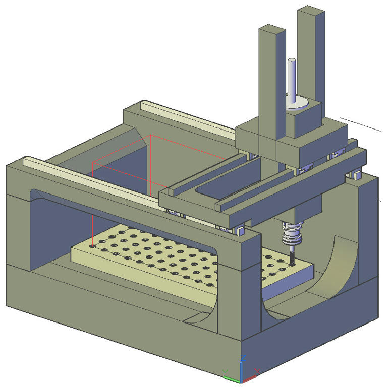

Gantry mill. (note this is not a light weight mill made from steel tube) At the high end of machine tools, nearly all the vertical mills are gantry style for rigidity.
If you are making a machine from scratch mineral castings made from epoxy and aggregate (with steel reinforcement where needed) are definitely worth considering. The castings are made using wooden formwork. Precision flat surfaces are cast against a surface plate. All screwed attachments are cast in metal inserts.
The attached photo shows a design I am working on. Yes I will post the final CAD files here at MEW when I have finished. It has a work area of 300Wide x 600Long x 300high (The box in red); the base area is 1000mm x 700mm this is the first draft and feed screws are not yet shown. And yes it will be Mach3 CNC.
The work table is a mineral cast with 20mm x M12 metal inserts for clamping. At some point the machine itself can be used to make a cast Iron one with slots if needed.
If you are thinking of building your own this method is well worth studying.
The only bought items will be the linear ways and feed screws. A lathe will be required to turn the spindle (INT40 taper) and other small parts. A small mill would speed the build but is not a required item.
The same methodology could be applied to building a lathe. Haas lathes now use linear guides instead of a ground bed. as do a number of other machine builders.

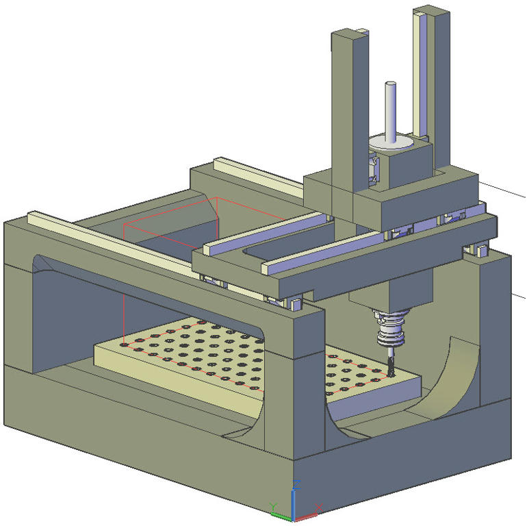

John McNamara21/08/2011 06:10:33
avatar
1377 forum posts
133 photos
Hi All
An Update....The Z axis now has bearings. A bit of interference with the Y axis carriage as I made the Z axis frame wider, but that will be sorted, finding interference is an area where Cad really shines.
Re bearings and rails: The prices are starting to become more reasonable. There is a lot of competition on the net. They are sold in size series to ISO standards. Many manufacturers make to the standards. So rails and bearings (Only as a set) can be interchanged.
More to come I will open a new thread.
