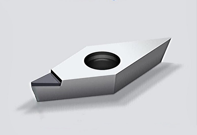

To be clear I’m talking about Polycrystalline Diamond Coated, Not the insert shape.

I mainly use the DCMT11 size and I really like the Sumitomo ones with all the positive geometry formed into the top of the PCD insert. The smallest radius is 0.2mm and they do 0.4mm as well. Either of the 0.2 or 0.4 mm radius will work.
I only use them for finishing. The simple geometry ones, like in the link, are ok, but are not in the same league as the Sumitomo ones especially when taking very light cuts.
They can be used either dry or with oil or with coolants. When used with IPA or IPA gel, like hand sanitizer, they will also give a great finish.
I always hear that alot of high surface speed or high rpm is needed, and I have found that is not the case at all. Ona 14.6mm diameter, you can get a really good finish at around 600 rpm or so. Cuts can be as small as parts of a micron with patience and a sharp insert.
There are now quite a few different grades of PCD these days, including coated ones. Some work well on the lower silicon Aluminum alloys, and the ones I use are for the high silicon Aluminum alloys . They also work on regular Aluminium as well. I have used then on brass and BeCu at work.
This is what I like here showing the positive geometry. Not cheap, but for certain things it does give a competitive edge.

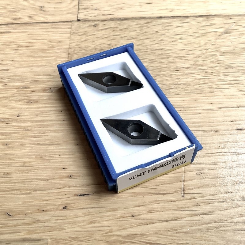

Looking at the description on eBay though and one of the suitable materials listed for them was Oak! As I do some wood turning as well this got me wondering. As some of you may know, carbide inserts have become quite popular with wood turners for some jobs. I’ve therefore bought a couple of the type below for £14 on eBay. The actual cutting tip is a bit short for wood turning but they are very sharp. I just need to make a tool holder for them now to try them out.
They were actually listed as VCGT but these say VCMT on the box, anyone know the difference, they look the same? Also the substrate seems to be carbide, is this correct?
The two are identical except the GT has a plain top whilst MT has a chip-breaking edge.
Chips are easier to clear than ribbons by ny experience suggests inserts have to cut fast and deep before the chip-breaker works properly.

Sorry Dave but the M and the G relate to the tolerance that the insert is made to.
Your typical **M* insert will be the moulded gold coloured ones with chipbreaker and "blunt" to the touch
Your Typical **G* insert will have been ground and or polished to get the Tolerance which also results in a sharper cutting edge
As for the T at teh end then that is what indicates if there is a chipbreaker and also how the insert is held.
Typical ***T insert has a has a 40-60deg csk hole and is single sided WITH CHIPBREAKER
Typical triangular Insert you may find on an indexable mill TPUN is neutral or flat topped with no chipbreaker

The ones I bought have a slight angle to the tip and being 160402 are quite sharp.
