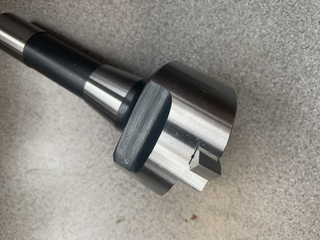

Never used one before. Bought one from Arc and a cutting tool
not sure which way the tool should be in the cutter
this is how it is atm

Tool needs to be turned through 90 degrees.

roatate it 90 degrees clockwise looking at your last image

Cheers guys, felt silly even asking

I used to use them quite a lot mainly smaller ones but like the others now use indexable shell/face mills.
Remember you will need to run at quite a low rpm to suit the HSS at the diameter being swung and also a slow feed rate a sit is a single point tool.
Carbide can be run around 3 times faster and depending on how many insert fed 6 or so times faster. so a cut may only tale 1/18th the time it would with a flycutter. The FC does work out quite cheap though as you can sharpen the tool many times provided you don't go near chilled cast iron with it. Compromise is to put a left hand lathe tool into the flycutter so you can at least spin it faster and feed accordingly.

I have never used a fly cutter ! Far from being silly it has told you what you needed to know. As for speed I would use standard cutting speeds for the material being cut. Tables or others on here will give you the figures. Multiply the dia of the cut in inches/12 by Pi (3.1416 ) and then by the revs ! if using imperial it will be Ft/Min. If you want the calc done give me the dia. Noel.

I use a fly cutter quite a lot. You can sweep a fairly large part and the finish I get is really good, better than a face mill. They are also incredibly cheap to use with a piece of HSS. There are of course commercial ones with inserts like this.

You set it up so the toolbit cuts just like a lathe tool, except in this case the tool is moving and the job is staying still. But the basic cutting action is the same.
