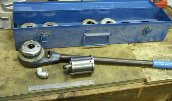

JasonB26/04/2023 14:32:01
avatar
25215 forum posts
3105 photos
1 articles
Big threads just need a suitable wrench/stocksmile p this one of mine is about 2ft long
My spiral flute taps have no more length of thread than the same size die maybe even less so not sure why they should not cut as quickly?
As he says the likes of Dormer do more solid dies than they do split ones and they also do hexagonal dienuts for cleaning up old threads.
I've several solid dies and they are quick and easy to use as there is no faffing about closing them down if the thread when first cut is too large
