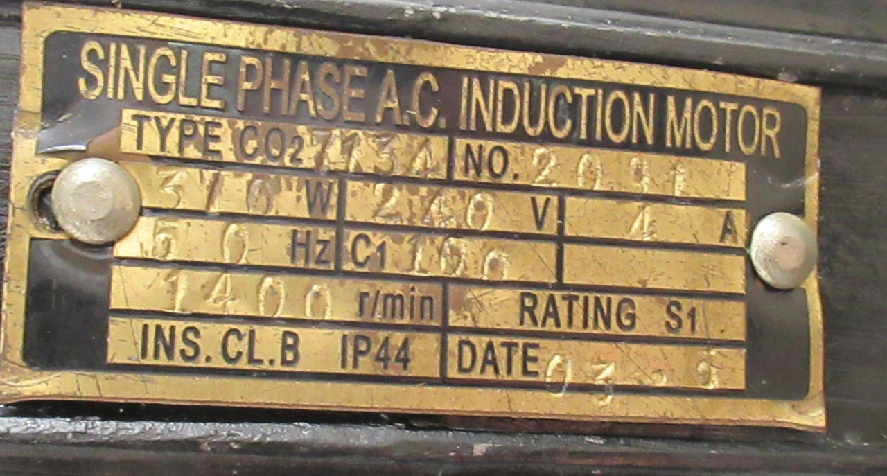

Induction motors are so widely available that your best option is to determine what frame size and mounting you need, then google to find the cheapest supplier of motors in that size and an appropriate power rating.
Unhelpfully your data-plate doesn't give the frame size and style, but you can easily determine the size by measurement and comparison with a chart (unhelpfully there are two standards IEC and NEMA) and the mount type by inspection (Downloadable reference here).
The "Type CO² 71 34" marking might be trying to say: "A face mounted motor (NEMA C-Mount), frame size 71 (an IEC size), with a 34mm long shaft", but if so is mixing it's standards, and should be marked IEC71 B14 (which would have a 14mm diameter, 30mm long shaft as standard).
