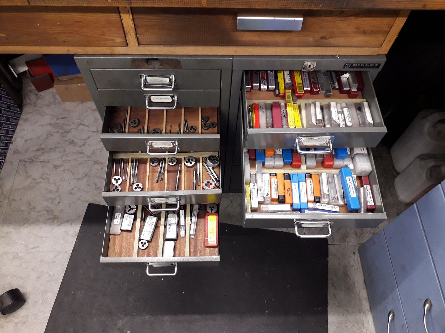

I'm much the same as Andrew, I buy what I need and have gone over to mostly using spiral flute, the ones from ARC for general duties like the odd jig or fixture and for the models I have YG-1 taps in the common sizes I use. Dies mostly Vokel from Rotagrip. Wrenches as I've bought them over the years cheapies do for the small stuff and I've a couple of Eclipse ones that are nice. Common sizes for me are M1.6 - M4 on models and to to M6 on jigs I seldom use larger with the exception of the off metric fine or pipe thread.
As for storage I put a sheet of 6mm MDF in th eBisley draw and then superglue small strips of the same to that to divide the draws up. Bottom left is metric taps and dies in their plastic boxes.
