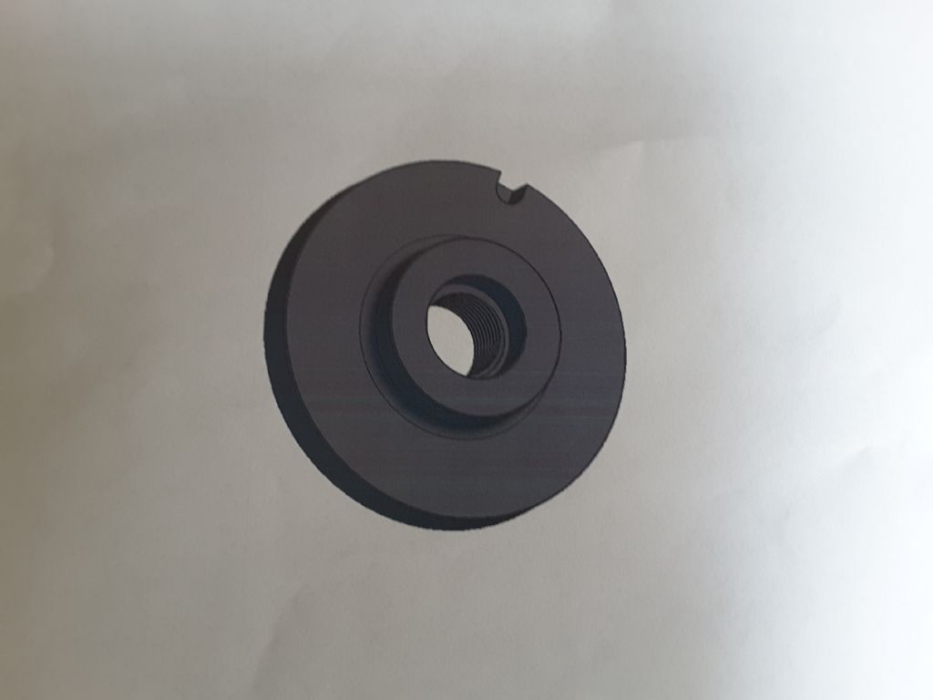

David George 115/01/2023 13:43:32
avatar
2110 forum posts
565 photos
On my lathe I have a notch for a C spanner which if hit with a small mallet removes the Chuck. As it is in the back plate it dosn't alter the chuck which a spanner on a jaw or on a piece of hex bar can if as like my chuck it is screwed on with 6mm screws. No load on the screws just directly on to back plate and less leverage on the spindle. Do not in any way use the back gear as the gears will be damaged. Just hold the spindle pully etc and a sharp tap on the C spanner will get it free.
