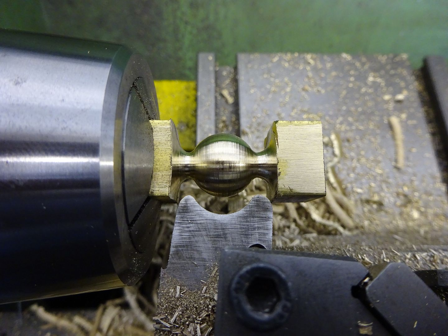

I'm aiming to produce some finials/ball shaped ends around 3/16" diameter and proportionate length - also some half-round mouldings of around the same size to decorate stanchions. This seems a good opportunity to develop my skills as a machinist into making and using small form tools.
However, I can't find any guidance on the thickness of gauge plate to use - presumably there's a trade-off between robustness of the tool and the amount of work required to produce an accurate profile with appropriate clearance angle (i.e would obviously be ridiculous to make a tool of this size from 1" thick plate, but 1/8" might not be rigid enough).
As usual, advice from those with experience would be much appreciated.
JasonB01/01/2023 20:28:40
avatar
25215 forum posts
3105 photos
1 articles
I would say 1/8" will be OK for that, just avoid too much overhang from the toolpost. These 9/16" dia valve bodies are being cut with 1/8" plate. Same tool doing these steel acorn nuts

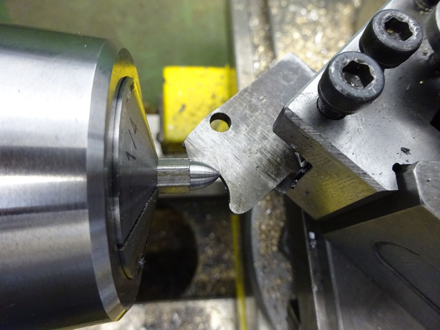

Jeff Dayman01/01/2023 20:52:24
2356 forum posts
47 photos
Another way to make "insert style" form tools from .093 or .125" gauge plate is shown in the pics.
